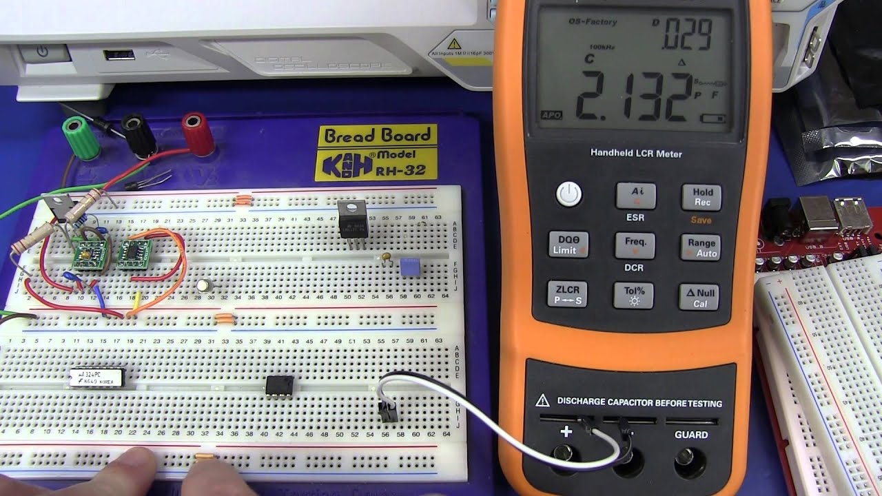

See eevblog investigation into capacitance and the breadboard:

Ok, so 2 "puffs" it is: alas, I have no idea what the implications of that are. Is 2pF capacitance between adjacent rows good, bad or irrelevant.
One point, if it dosen't oscillate on the bread board then it more than likely not oscillate on your PCB. :wink:
I have used a bread board at 20MHZ with no problems but obviously it depends on the circuit.
Also, if it works on the bread board, it may not work on a PCB as you may have to add capacitance to your PCB circuit to get an oscillator design to work.
I guess the point is be aware the capacitances are there and they will effect your circuit (pro or con).
Also the long hook up wires used in a breadboard design will act as caps or inductors/antennas.
2pF good or bad... depends. On lower frequencies, no difference.
Xc = 1/(2pifC)
Square waves contain the fundamental plus odd harmonics, requires up to about 9th harmonic to look relatively square. So calculate the capacitive reactance at that frequency. If it is in the range of the resistances around it and not at least 2 to 3 times higher, you'll see ill effects.

I've measured between 2pF and 15pF between adjacent rows on a variety of protoboards. I'm sure it depends on the geometry and the dielectric constant of the plastic.
