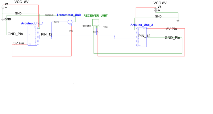

I am having all sorts of trouble getting a transmitter/receiver working on UNO.
I currently have the trans and receive DATA pins hard wired.
Have enclosed a jpg of this. Apologies for poor pic quality.
Have seen and read so many installation instructions I am pretty sure my pin setups are correct.
The following sketches are the first I have able to receive anything on the receiver side.
What does that mean, and how have you done this?
Often there is direct connection between the two Arduinos to eliminate the radios and test the code, but you are running the standard radiohead library examples for RH.ASK.h and this is known good code.
For the code test, the pin on the Arduino which is going to the TX of its module is not connected to the module, but instead is connected directly to the pin on the other Arduino which would normally be connected to the RX pin of its module.
Sorry for my lack of info. I am very new to this and am not really sure what was required.
This is the EBay link.
This is a diagram of my connections to bypass the radio connection using the RadioHead sketch
The default TX pin is 12 and the default RX pin is 11. The pin 12 to pin 12 connection is wrong. I have done some testing with my modules, and you may be able to run the direct connection and the radios at the same time, but you really learn nothing by doing this. The direct connection is to test code without the radios powered or attached.

As pointed out in reply #5
uint8_t buf[24];

My question was is the code correct?
No.
If not where have I gone wrong?
You have used the syntax uint8_t buf(24) instead of uint8_t buf[24]
Do i have to delete a line of code in the sketch and and replace it with "uint8_t buf[24];"?
Yes.
// uint8_t buf(24);
uint8_t buf[24];
Where in the radio head ASK example did you find the use of the parenthesis instead of the square brackets? Why are you still running your code instead of the library example code?
In fact, you commented out the correct syntax and replaced it with your version. What motivated you to do that?

Thanks mate at least its now working in a fashion.
Will not work wirelessly but works ok hard wired data to data.
