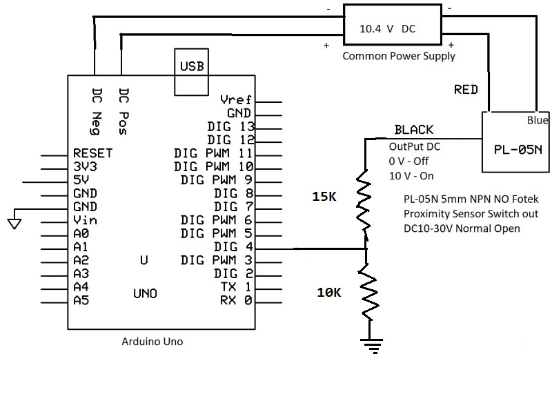

Please see image below. I want to use a few proximity sensor switches for a lift /elevator project for my old/heavy German shepherd dog using an arduino UNO. Travel 6 Ft.
2 questions please if you will.
  1. Will this switch connection work?
  2. What value resistor do I need.
The 10.4 Volts DC will be coming from 8 X AA rechargeable batteries.
The lift will raise and lower 440 lbs the 6 ft in 10 seconds.
No, it will damage your Arduino.
  1. What value resistor do I need.
You need two resistors in a potential divider configuration.
I would use 10K for the bottom resistor and 15K for the top.
Sensor seems to be a 3-wire NPN type (internal switch to ground) with a weak pull up (47k) to it's supply.
If so, you can connect the output directly to a digital input pin.
Or use a 10k resistor (as in your drawing) if you're not sure.
Should work both ways.
Leo..
Edit:
A 10k:15k divider with the sensor's internal 47k pull up won't give a proper HIGH (1.75volt).
Another solution is internal pull up on the input pin, and a diode (1N4148) between pin and sensor.
Cathode to sensor.

This is now what I'm planning using the recommended divider.
No, I didn't see the 47K internal pull up in the spec, mainly because you did not post a link to it.
As Wawa correctly put it:-
So either follow one of his suggestions or remove the 15K altogether and change the 10K pull down to a 39K pull down.

I'm back trying again.
Paul__B messaged me that I should really use Wawa's last recommendation above which is....
"internal pull up on the input pin, and a diode (1N4148) between pin and sensor.
Cathode to sensor."
What would the value of the PullUp be? Did I get it right?
![](http://www.hubka.com/PL-05N switch_4.jpg)
Thanks
Internal pull up means activating/using the resistor INSIDE the Arduino chip.
pinMode(pin, INPUT_PULLUP);
If you do that in your code, then no external resistor is needed.
Leo..

"pinMode(pin, INPUT_PULLUP);
Leo.."
OHHHhhhhhhhh I get it.
Remove the pullup in diagram above above use the code:
That is Way Cool!!!
