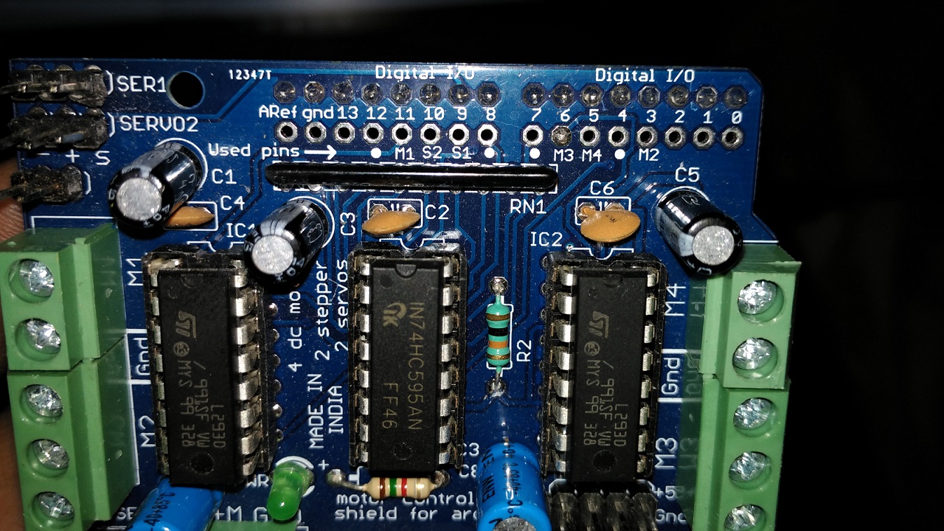

well i'm using the shield in the image below.
If you can see on that picture whether pin 11, 12 or 13 are used, you have better eyes than me.

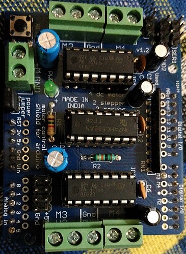

Sorry about that. Here is a better image which shows the pins.
So it seems 12, 11, and 10 are used.
You could try SoftSPI on the free pins (analog pins are probably unused).
