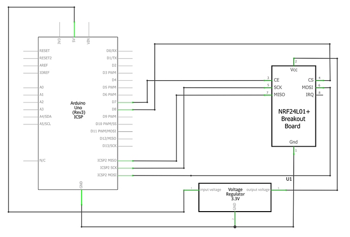

here's pics of the Arduino uno wiring as schematic(its not fully accurate as the 3v3 reg is in the adapter which has capacitors in it but the spi connections are same)

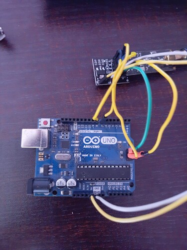

and the physical uno

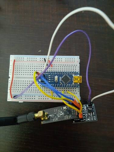

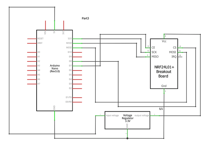

And this is a schematic and irl pic of the nano
This is the adapter I am using

Also, in situations like these, I always trace the connections with a continuity tester to verify that there's no contact problem. You've got a breadboard as well as the connections to/from the voltage regulator adapter board, so plenty of opportunities for faulty connections and mistakes in wiring.
no, no mistakes in wiring because if there were any than the output of the serial monitor with be zeros and yes, i have used a lower PA level, PA MIN as specified in the post
You are using the Arduino as a power supply something you should not do. I will take a SWAG and say you did not read the data sheet for the regulator, it requires capacitors. Best solution is to use an external power supply for the motors.
You have shown the output for only one device. Is it exactly the same for the other?
Yes, it is same for both
When i checked the current output on the adapter it had max of 1 amp at 3v3 when connected to arduino 5v output, so i assumed it would be ok as nrf24l01 usually doesn't draw more than 300mA
What is the Arduinos Max output current? What is the peak current of the nrf2401l when transmitting? What did the data sheet say about the regulator? Good Luck!
