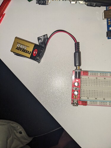

With this I tried using an external power supply as shown to supply the module with the hope to provide enough current. Still no luck.
Additionally, I update my RF24.h library and still no luck. I am starting to wonder if my module is actually just fried and if I should get a new one.
Here is my set up finally, I don't think the wiring could possibly be wrong, ive reconnected it so many times now that it should have been right on at least one.
Any other suggestions welcome

I see that you are using the power adapters so the power should be OK.
You only posted the transmit code. Where is your receive code?
I suggest that you change your wiring to match the tutorial and use the power adapters and try the tutorial example code. That code is known to work.
