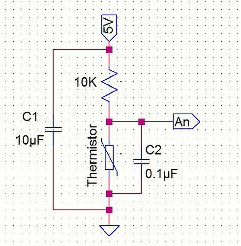

I have 6 ntc thermistors and 6 10k resistors are connected in series and am trying to measure the temperature. But due to some noise am getting a fluctuation in the temperature. so am putting an 0.1uF capacitor between the NTC and Resistor to smoothening the output in constant.
but my question is, is it okay if i connect all the 6 NTC to the same Capacitor and raising the value of capacitor to 0.6uF or is it necessary to use separate capacitor for all the 6 NTC thermistors.
Surely, If you use just 1 capacitor, that will connect all 6 NTCs together - so you won't be able to read them independently?

How do you intend to connect these 6 NTCs? Show your schematic.

Do like this:
Hello, I have done a schematic same like this but the 10uF is not included in my circuit.
one more question from my side like example, i have used 6 NTC sensors so is it necessary to use individual 0.1uF cap for all sensors ?
here is my schematic
Yes
Thankyou, Got it !

If you use an Uno, and power the thermistors from 3.3volt (your diagram), then you get potential instability, because the result now depends on temp and supply variations. For a thermistor, pull up voltage and Aref voltage must come from the same point (ratiometric preservation). Grounding is also very important. Thermistor ground can't be shared with other devices, like on a breadboard.

I am using Arduino Due, i have powered the 3.3V to resistor and connected the thermistor 1 end to resistor and other end to ground.
Yes, the Due is a 3.3volt board, so your setup seems right.
