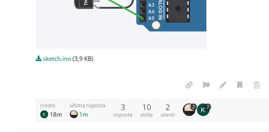

I am using the attached NTC and connected it in series with a 10k resistor, supplying the series with 5V from Arduino.
It is a very ordinary circuit to detect temperature ... but I measure a temperature of 17 C° when I have about 23 C° at home.
I can't figure out what is going wrong.
The voltage at the ends of the NTC is sent to pin A5 of Arduino and I wrote the code to calculate the temperature.
Since the NTC is connected (soldered) to two wires that act as an "extension" to get to the Arduino, I did not state the R0=33k at T0=25°C as on the datasheet ... but with the multimeter I measured the resistance of the NTC (at 25°C) ... that is 37k ... so on the Arduino I used R0=37k and not 33k.
(If I leave 33k measure 15°C)
NTC-2.pdf (165,8 KB)
sketch.ino (3,9 KB)

As I was pasting the code here I realized that I had not initialized the NTC pin ... what a stupid mistake I made!
pinMode(readPin, ntc_pin);
Sorry for wasting your time, the important thing is to have solved and understood the error.

It starts with the NTC.
I think that a 37k NTC does not exist. If you have a 37k NTC, then you have to know its Beta. The best accuracy is when using a lookup table from the manufacturer.
Since you have a unknown NTC, you can not calculate the temperature, you can only make guesses.
Was the NTC overheated perhaps ? and now it is damaged ?
I came across this document that shows how the formula is not ideal: https://catalogs.kyocera-avx.com/NTC-Thermistors.pdf
Please explain what that line of code is. Can you show your whole sketch ?
Don't assume you will get exactly 5v from there...........

This does not look right. Your sketch has ntc_pin defined as A5 undefined, which is not INPUT, INPUT_PULLUP or OUTPUT .
By default, the pins are initialized to all be pinMode(xxx,INPUT)
