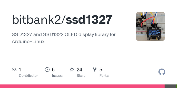

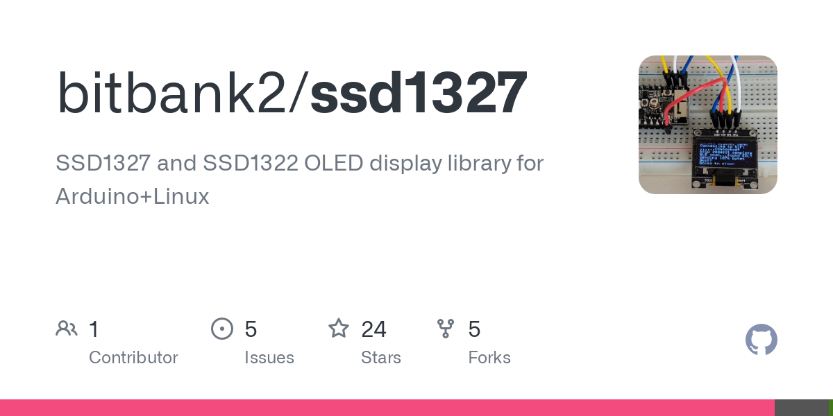

try this?

I’ve read this but it doesn’t contain anything that helps solve my particular problem

You have "read" it? It's a library. Try it. The gentleman has a wealth of experience with OLEDs. I've used his slimmed down libraries before, but with 1306 type. I have no reason to expect his library not to work, or he'd likely not have made it available. Note, you have to use his bitbanging library as well.
