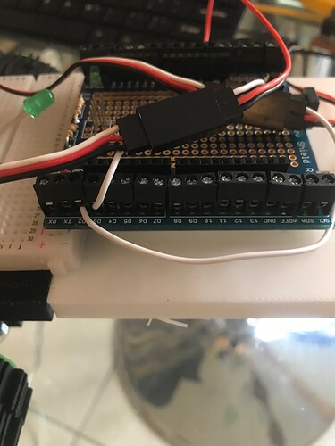

Hi, I have started teaching myself to do projects with arduino and raspberry pi from the start of this year, so am still learning a lot. I've been working through the mind-controlled arduino robot project (the MakerPress book) since June and and stuck on one aspect of it: I have printed the chassis, wired it up and loaded the first two pieces of basic code on it, but only one servo motor runs. I will attach photos of the robot in its current state, top and bottom (had some trouble doing this, so will attach the photos to a reply to this thread).

Some of the troubleshooting that I've tried so far:
  • Swapping the leads for the two servos with each other (you'll see the connector halfway along the cable). When I did this, the other servo ran.
  • Using digital output 4 instead of 2 (wiring and code). Before I did this, the left wheel ran well and the right didn't run at all. After I swapped, the right ran poorly (maybe 5 degree turns intermittently) and the left wheel stopped. When I went to set it back, as soon as I disconnected the digital output from 4, the left wheel started again.
  • Put the two servos into separate grounds rather than the same. No change.
  • Tried running with two other servos and got the same issue.
  • Tried running using a different arduino (uno) and got the same issue.
So I think it must be something to do with the screwshield, but can't work out what. I'm new to soldering (and everything else!), but I fixed any soldered pieces where two inputs/ outputs were touching. I can't see what else it could be.
Would be interested to know any thoughts anyone has on what the next steps should be for troubleshooting.

Your dark blurry picture does not allow us to spot any problems. What we need to see is close-up, bright clear photos, and a schematic.

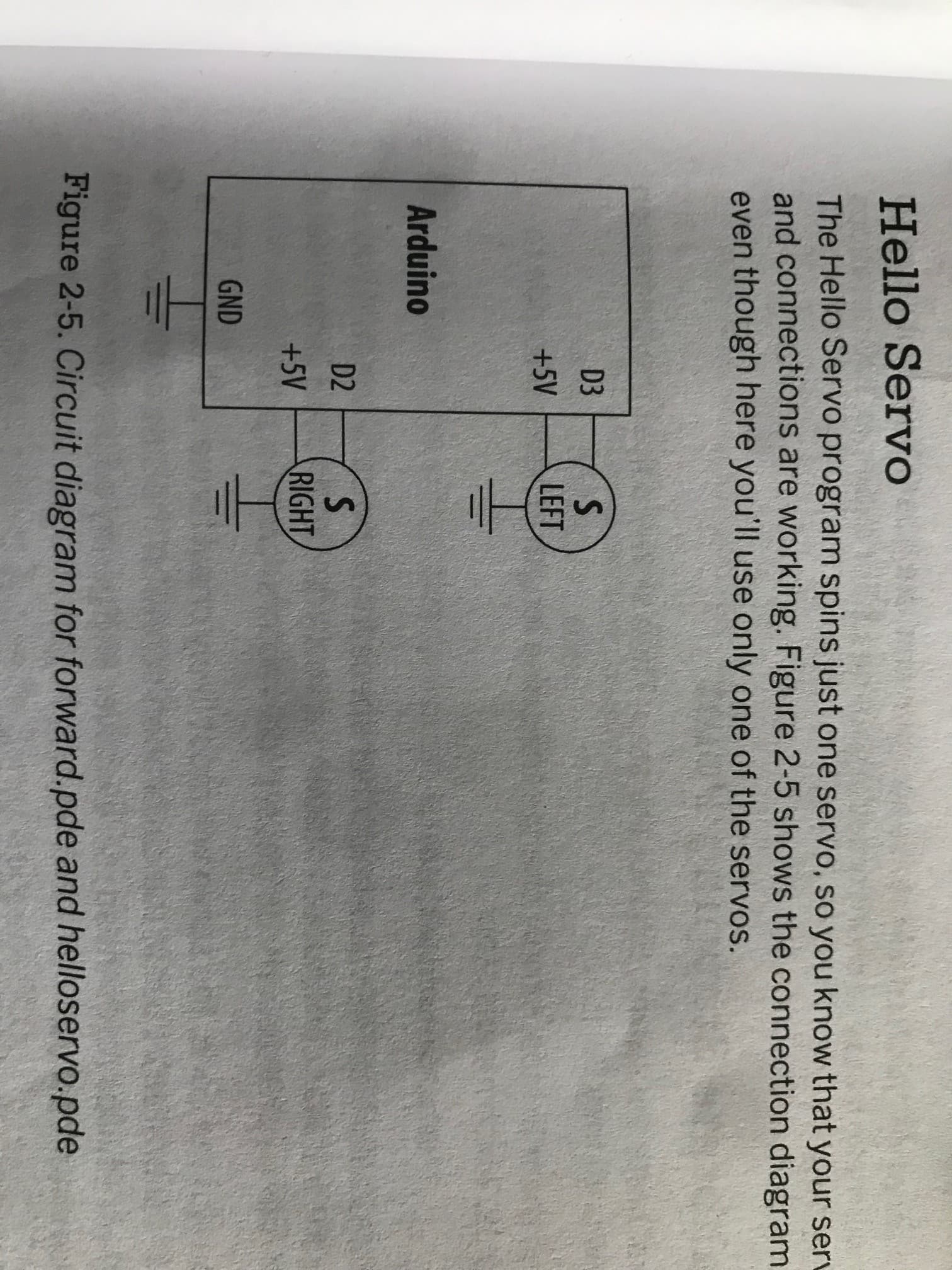

Can you please post your code in tags and can you please post a circuit diagram of your project.
Please include power supplies and component and pin labels.

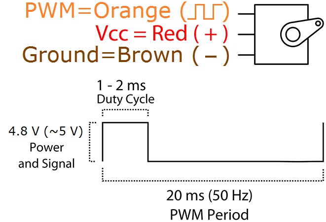

As you change microseconds HIGH you do not change how long LOW is to compensate and keep the PPM servo signal at constant frequency.
Case1;
When you have a 1000us high you have a 5us low, period of signal == 1005us.
Case2;
When you have a 2000us high you have a 5us low, period of signal == 2005us.
Your pulse frequency changes by a factor of 2:1.
It should be constant.
You should be using Servo library.
It's PWM.
PPM is just the stream between transmitter and receiver

Thanks for responses. Am going through them. I put my code into code tags and have attached a schematic picture. I'll attach some better pictures of the units.

  • The book includes code which I've included above for running the servos. It does mention the servo library and points to the pluses and minuses of this bespoke code. I really don't think the code is the issue and is straight from the book - I posted it to help people understand how it works. I very much see this as an electronic/ wiring issue and am interested in views of how I could troubleshoot it further to get to the root cause.
  • I'm attaching a closer picture of the left side following a comment that the pic I posted was hard to see detail in. I will post another in a moment of the right side.
And a picture of the wiring on the right side:
In theory, yes, in practice no.
Servo is expecting a constant frequency, variable duty cycle.
eLZ88
In fact 50Hz, the code above changes the frequency as well as the duty cycle.

What do you mean by this - what's powering the Pi?
Servos pull quite a lot of current and in consequence, the vast majority of issues that involve them are power related. Your low voltage alarms tend to suggest that that's the case for you too.
Hi, I tried the code changes you suggest with setting them both to 1000 microseconds in the pulseservo routine and keeping the two delays the same. The issue persists where the left wheel runs and not the right.
Both servos are grounded to the arduino through a screwshield.
The two servos are connected to the same 5V supply point as per the photos. I disconnected the left wheel from the 5V supply to see if the right started to run, but it didn't.
Hi, I tried that. The left wheel runs backwards and the right doesn't run.
The longer term plan is to run the robot on a battery, but for now is powered by a pi that I'm writing the Arduino code on. That pi is powered from the house mains (220V) supply.
