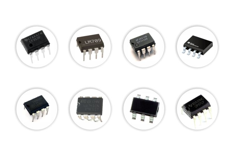

or like this one
that listed parts that were obsolete in 1970. (uA709 ?)
