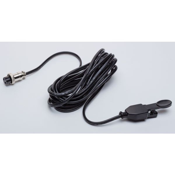

Thanks for the replies @TomGeorge @cedarlakeinstruments I have attached a circuit diagram, code and picture of a similar trigger button that I am trying to replace with the arduino.

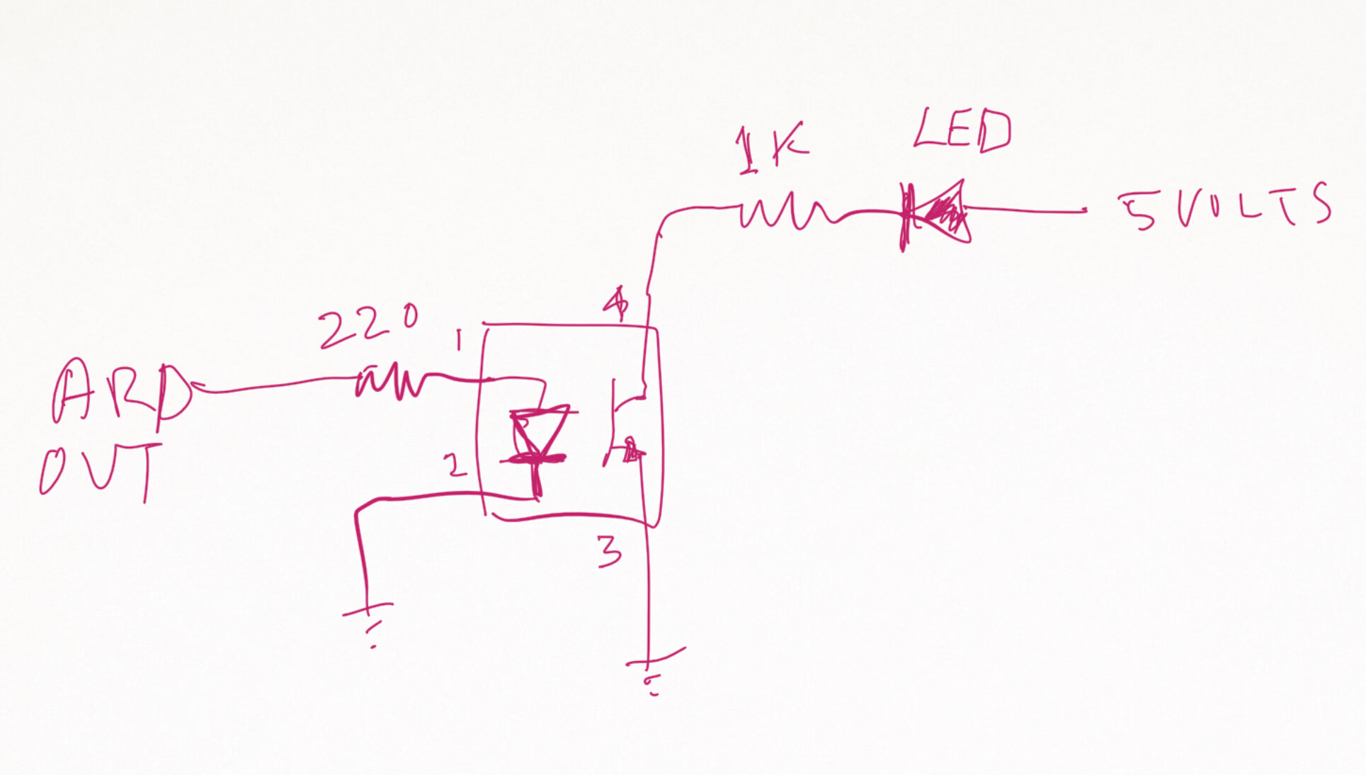

@jackdavies by now you may have damage your opto.
Try this testing circuit, see if the LED does what it should:
Sry if it looks like I drew it with my finger. There's a reason for that.

I wouldn't connect the real welder to this project until all kindsa other issues were completely solved.
Thus my advice to use a proxy LED on the opto output, which opto as far as I remember has not shown itself to be functioning.

Thanks to all for the responses so far, I swapped out the opto and changed the resistor to 1k which was what was on the HW-532 mosfet board that I took the opto off.
With the 220ohm there was a measurable signal but not enough to light an LED, I put the LED on pins 1 & 2 of the opto to make sure the arduino was outputting to the pin. It is working now, however it feels like the switch is 'soft' and when plugging in the normal switch trigger, it is a much stronger pulse. As I am writing this now I kind of realise that the 1k resistor is probable not the right value, and could be causing this 'soft' behaviour. I did test two different 220ohm resistors though so thats also quite weird.
