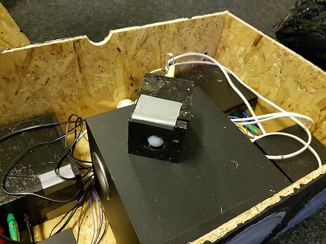

pics of the electronic boxes
What makes you think false triggers are false? Are you there to witness nothing present when it is triggering, or is it possible the triggers are real like from wildlife?
Those particleboard boxes don't exactly look weather proof to me. I prefer to use ready-made plastic boxes for outdoor use.
I found basically two ways to stop condensation from ruining your electronics.
  1. seal your box very well (as in VERY well: rubber gaskets & screws, not click-clack tupperware, and screw gaskets for the wires that go in and out). If not sealed well, air pressure differences due to temperature will suck in water. Potting in epoxy is another way of very thorough sealing.
  2. make sure your box ventilates well. Some openings in the bottom work great. You may still get condensation in 100% humidity conditions (a common occurrence in my climate; don't know about yours). The heat from the electronics (keeping the inside a few degrees above ambient) is enough to stop that from happening usually, and conformal coating is a good idea as well.

I don't think heating is necessary for your boxes, at least in my case the electronics themselves do just fine to keep the inside a few degrees above ambient, which in turn should be enough to keep most moisture out or at least stop it from condensing (which happens normally when an object is cooler than the surrounding air).
For your false triggering: make sure it's an actual trigger of the sensor, not noise on the line (the first usually lasts a second or more depending on your sensor; the second much shorter). You can do this in software by checking back one or two times with say 100 ms intervals. If there is noise, a small filter cap (100 nF) and/or a stronger pull-up resistor should help to stop this from triggering the Arduino.
