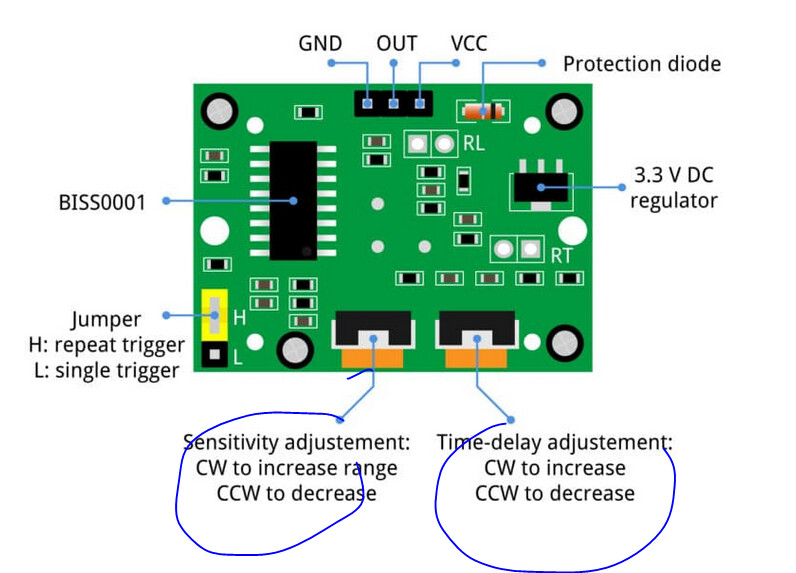

Been finalizing my 12 month project and hit another snag.
Read Pull up? Pull down? Float? so no need for pull up/down resistor.
HC-SR501 PIR sensor I cant find any decent info on the two time and sensitivity adjustments and hoping someone here can quickly put me right before I revise code.
Locally I grabbed this PIR
Set to L - single trigger
Two adjustments
Until I got ready to mount and was doing the final testing its now false triggering.
Q. with the PIR lens facing down and circuit board up I have turned both pots CCW for 3 secs delay on trigger and 3m sensitivity range.
I see a lot of discussions and information on the net but seems to be different.
Note my sensor is a XC4444 PIR Sensor but the documentation mentions
The HC-SR501 PIR sensor has a lens which focuses the IR radiation given off by living things, and toggles the output pin high when it detects movement.
Any advice appreciated.

Powering the PIR with 5V creates a borderline situation. The PIR specs mention 4.5V-20V as acceptable input power. But…
The VCC pin of the PIR module feeds a 7133-1 voltage regulator through a diode. This regulator can work with an input voltage up to 24V, its nominal output is 3.3V.
The actual voltage getting to the regulator after the diode would then be about 4.3V, depending on the diode type. The specs for this regulator call for an input feed of 5.5V. A lower voltage does not guarantee an output of 3.3V, maybe not even 3V.
The PIR is based on a BISS001, which works with 3V-5V according to the specs. If the regulator delivers less than 3V the BISS001 can fail.
I have a night light based on a PIR powered by a 9V rechargeable battery. When the battery has low voltage the PIR starts with false triggering. That is my cue to install a fresh battery.
Bottom line, make sure your PIR is powered with at least 5.5V. You can get away with 5V if you are lucky. Do some testing.

Thanks thats great feedback. I do have a converter where I can supply with 12v or 5v.

A friend power his HC-SR501 all the way down to 4.5 V and it works (I haven't heard otherwise). If there are different manufacturers I'm sure there are variations in the design and components used.

What board are you using? If, for example, you use a classic Nano powered via USB, the voltage is only about 4.7 volts because there is a Schottky diode in the power path.

Thanks to all that responded. In the end I reviewed my code and found a loop that seems to occur very randomly.
I added another PIR BTE16-19 that has a LED when changing state and found it going on and then off.
Cant fault my code but rewrote the function and still running with out a issue. Funny thing is I found I had the HC-SR501 on 3.3v not 5v.
