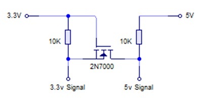

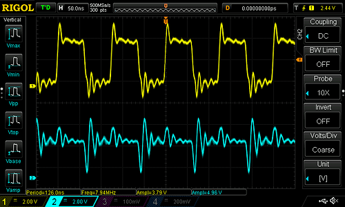

I'm using a voltage divider to change xclk level but it's slow and I want to switch to a faster and cheap solution, so I'm using this bidirectional level shifter to convert xclk to 3v3
but my clock looks like this and the module doesn't work (yellow before conversion and blue after conversion)
does anyone know why the converted signal looks so unrelated to the original?
edit: I figured out that scheme should be specific for i2c and resistors are not part of the level converter; so I plugged the xclk in the gate, 3v3 in the source and the drain to the ov7670 and it looks like it's working
but now my image "slip"
how could I fix that? could get better performance with bss138 instead of using 2n7000? can anyone confirm my assumptions? Is what I'm doing safe/correct?

I'm not a expert in eletronic, but maybe there is some detail in the use of 2N7000 that makes it not properlly for use in a clock circuit.
Some diods in serie wouldn't fit for the purpose?
@Flaviold: I saw some sparkfun level converter using bss138.
The only difference I can think of is about the gate activation threshold which is lower (better) on the bss138 which is 1.3V versus the 2.1V of the 2n7000 (I'm going to buy 'n try those).
This could be the cause of the noisy/uneven wave you see in my clock signal.
You shouldn't use diodes to step down signal levels because at such high frequency and low voltages a lot of factors come into play (hysteresis, parasite currents, dispersion and... I don't know what else but surely there's other nasty stuff). It will be worst!
I'd like to use passive components avoiding buffers, mainly because they are cheaper and they look more professional to me.

many solution has been proposed for this matter:
mr arduino uses a 74AHC125 buffer, I used a voltage divider (which work but is slow), I tried a 2n7000 with a little luck, and now my bss138 are on their way to my home to test this other solution which should be cheaper but as a matter of facts mr arduino's 74AHC125 is the only stable and cheap solution for the clock issue for now :wink: a clock generator would be cooler but more expensive than the right transistor which, I believe, do exists. Bonus: a good transistor can be re-used for other signal converting issues; a clock generator is suitable only for this specific case (generating a clock).
