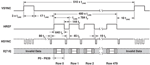

ok time to post something! :smiley: I'm making some nice progresses on DUE but I'm stuck with a couple of things:
  1. DUE can't get over 250000 baud rate or else it'll output garbage out of the serial. How do I overcome this and get at least a 1M baud? (can't belive DUE's serial is slower than UNO's!) For now I set a value of 63 (0x3F) for the 0x11 reg. Should be ok uh?
attachInterrupt(PCLK_PIN, pclk_rising, RISING); //hangs because (IMHO) pclk varies too fast firing too much interrupts. so I'm using a fallback code
while(!((portC = REG_PIOD_PDSR) << 22)); //but this looks wrong to me. isn't it?
Anyway here's the full code with an output frame and wiring instructions in code. It should write just the colorbar pattern. Any help would be appreciated!

	while (!onFrame);
	for (int i = 0; i < WIDTH * HEIGHT; i++)
		//pin8 is port C22 as stated here -> http://www.arduino.cc/en/Hacking/PinMappingSAM3X
		while (REG_PIOC_PDSR & (1 << 22)); //wait for low
		Serial.write(REG_PIOD_PDSR & 0xFF);
		while (!(REG_PIOC_PDSR & (1 << 22))); //wait for high
	Serial.print(F("*FRAME_STOP*"));

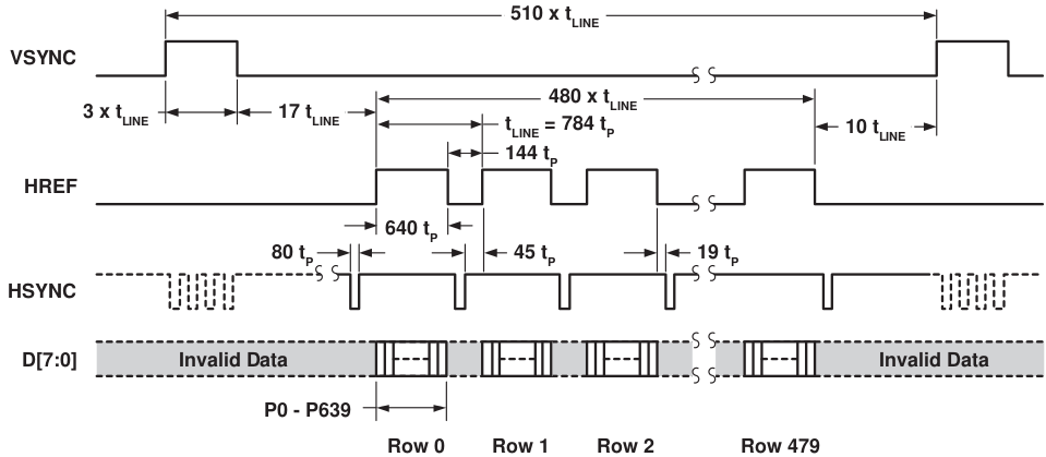

	//Wait for vsync it is on pin 3 (counting from 0) portD
	while(!(PIND&8));//wait for high While vsync is low
	while((PIND&8));//wait for low   While vsync is high those 2 lines detect a falling edge on
			//vsync which means the start of a frame

I'm also struggling to find the meaning of the HREF, HSTART/STOP registers. I have attached version 1.4 of the datasheet dated August 2006. Hope it helps.
sht001.pdf (738 KB)

True, but in the code you posted you are not using HREF at all .. pin 8 or D22 is the pixel clock..
This is why we use macros .. much more readable hehe..
your code ...
while (!onFrame);  // this is VSYNC
// no waiting for HREF here ..
So ultimately you grabbed the next (width*height) bytes after the rising edge of the VSYNC.. many of which are the ones indicated on the timing diagram you posted as invalid data.add that to me originally writing my data to the LCD in the incorrect orientation, windowed badly and also offset by half the screen and my valid data was not making it onto the LCD at all.
So my first grab of real data was when I realised the interrupt was better served on the trailing edge.
Once I got some image data then I quickly found the other issues.
I can't see why a trailing edge interrupt would not be preferable, gives you longer at the end of a frame to perform any processsing before having to lie in wait for HREFs again.
I now have the LCD working using DMA and so my speed limit is very definitely the data reading side of things, I have your clock divider down to 15, but looking into whether we can use the due as a parallel slave device and use an external control line (pixel clock) to DMA transfer the image data.
also I am still getting so much 'padding' on the pixel clocks between HREF, my el cheapo saleae clone arrived this morning so as a first test I have it counting pulses.
my first test and image capture !
1536 pixel clocks per HREF .. sigh..
(click for full size imgur)
edit2: I just counted 18188 pixel clocks from the rising edge of vsync to the first HREF pulse..
