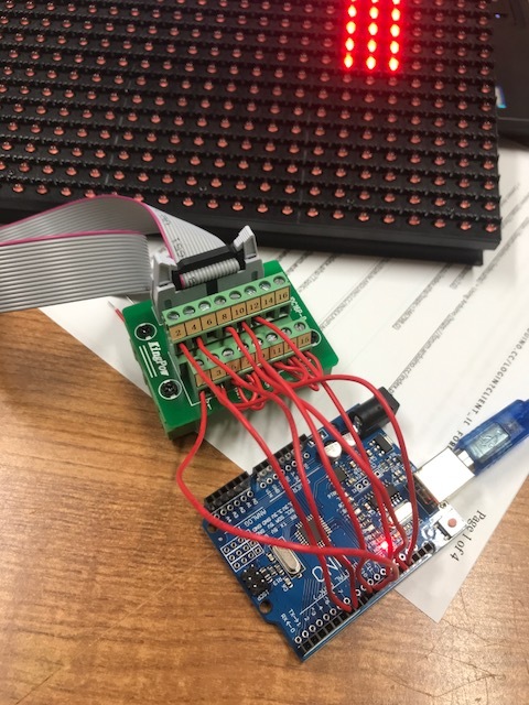

I attempted the same process with the P10 when it arrived, but haven't been able to make any progress. I've tried nearly all of the wiring configurations available for both the UNO and the MEGA with no results.
Both arduinos work with the MAX7219.
The code that I am using to test uploads without errors or warnings.
The RX LED flashes on the UNO and I can see the code working in the serial monitor.

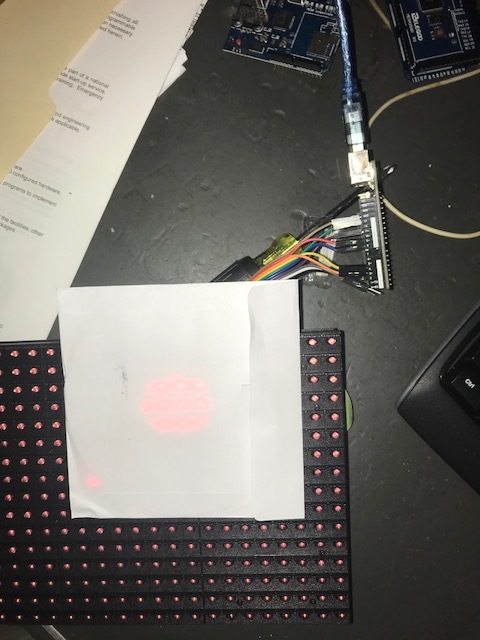

The P10 LEDs turn on, but are inconsistent and do not display what they should.
Here is one of the wiring diagrams I tried with the MEGA:
Here is one of the wiring diagrams I tried with the UNO:
I'm assuming that the P10 board I'm using has a different pin configuration, but I was not given any documentation with it. Does anyone have any suggestions on what to try?
This is a P10C4V1.6 panel and next to the pins there is a small diagram:
F F
N F
N F
N F
N F
N D1
N D2
N F HUB 12

Like I said - I've tried quite a few different combinations of code/wiring with no luck. Any and all help would be greatly appreciated.
