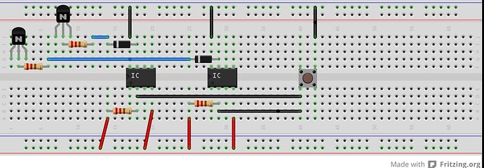

Hi again,
Just wondering if i wanted to remove one of the switches, would the attached circuit also be safe or am i missing something.
Quite safe, but why would you want to do that?
Note: one switch, only one pull-up resistor needed - or use INPUT_PULLUP instead of a resistor.
Thank you Paul,
Sorry i posted the wrong schematic, the correct one attached will be switching two different loads from a single switch and i'm just curious to know if it is safe.
Some notes on your circuit:
  • The collectors and emitters are not connected
  • The diodes are not needed where they are shown
  • The pushbutton inputs are shorted together. Not a problem unless both get configured as outputs.
  • The pushbutton has 2 pullup resistors, only one needed.
Same comments!
