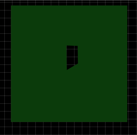

i have had great luck using easyeda pcb design software, and then ordering the pcbs off of JLC pcb.
i do it like this:
I use the edge layer in KiCAD for e.g. slots between mains and low voltage parts. Always came back right from Seeed and JLC without any additional interaction. It also displays correctly in their Gerber viewer.
