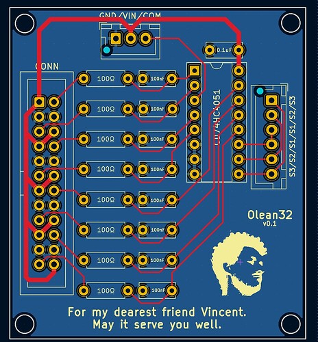

PCB for Multiplexer Layout
Also a really good advice regarding the power trace :smiley: Thank you,I just changed it!
I'll design the main PCB asap and upload a picture of it and also of the connections between all of them.
I would make the power track thicker, they don't charge more for thicker tracks!

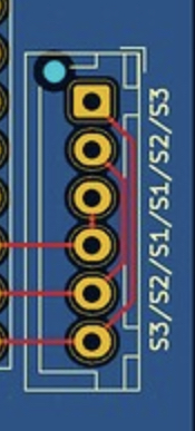

However:
Maybe spread these traces out a bit:
@LarryD
Oh, you are so right. I just changed it.
I also made the power rail thicker, as @PerryBebbington suggested.

Very close now !

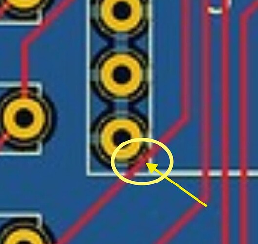

Move power trace away from the mounting hole and watch clearances.

Clearances:

I also fixed the trace you've mentioned.

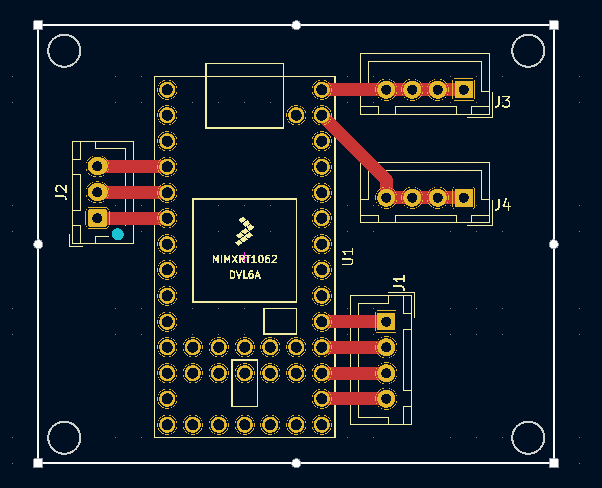

Hello! I'm back with the main module. What is your opinion in this one? Do I need a ground plane in this case? I'll upload the connection between main module and the mux modules soon! :slight_smile:
