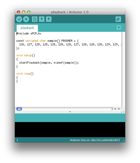

Can I ask what the stream of characters in the example for PCM mean so that I can check if there are any possible websites that can carry out the same function as EncodeAudio?
It is 8 bit mono at 8000Hz sample rate. So you will see values between 0 and 255.
