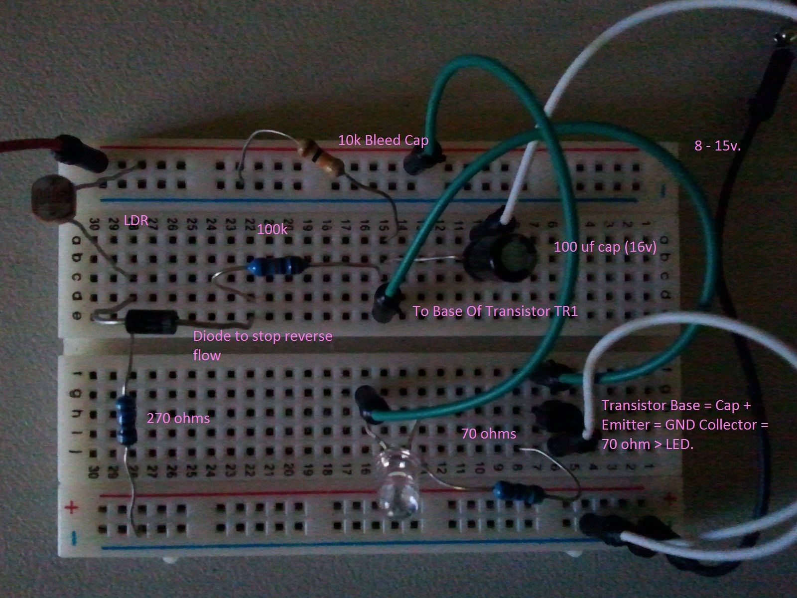

using an LDR, when it sees bright light, the resistance drops to only a few Ohms, when it's dark it's between 100k - 1m or so.
As you increases the light, the resistance will drop across the LDR, so basically you will have a rising/falling voltage across your resistor divider.... now If you take that voltage and place it in series with a cap (not sure the value without getting out the calculator) you can make the Cap slowly rise and fall in voltage - still with me?
The Cap's + terminal goes to a base of a transistor (via a resistor to limit the current further) - then have the LED slowly turn on :) (and slowly fade out as the cap discharges)
I'm curious myself and might go and make it on a bradboard, i'm so bored right now.
and here's a video of it ... You're going to have to replace a couple of Resistor Values, to match what your setup requires, eg your voltage, how powerful the laser is to light it, how bright you want your LED, etc.
https://www.youtube.com/watch?v=obPiIJ6opsU

Holy crap man. You whipped that up pretty quick! THANK YOU SO MUCH! :D That's almost exactly what I wanted! :D Is there any way to make the LED stay on if I have a 3.7V battery in the circuit somewhere?
ACK - I just noticed something wrong, the 10k resistor I used to quickly discharge the cap, but…
  1. Ground is not connected, does not matter what value that resistor is LOL - it’s going glow just as bright no matter what you use, after hooking up ground, 10k bled the cap dry, if you’re going to use it to discharge the cap, a lot higher value, try around 100k, it works for me…
Video uploading.
To make it work, connect ground, then place a 100k (or whatever suits you) between gnd and + on the cap, as the Light goes off, the voltage drops, the cap will drain via ground .

Ahh, you wish the LED's to stay on and not fade out?...
Good question, some kind of Latch then :) - probably require an IC of some kind to remember the state, someone else can probably explain how that works, all i can think of is a Latching IC, not sure how'd you do it with basic circuit components.
because as soon as the light level drops, the cap will slowly discharge making your LED's dimmer, you'd need a latch to stay delivering current until some kind of user input?

Yeah, exactly. I was hoping to essentially have some sort of photo transistor. Like, as soon as enough energy is put into the photocell, it opens the "flood gates" and allows the 3.7V to flow continuously. And, if it could fade on, that would have been ideal too. Don't know if it's possible, or how many components I'd need to make it possible. Just wanted to see if anyone had a simple solution for it. :) Thanks for all of your tips though. :D
