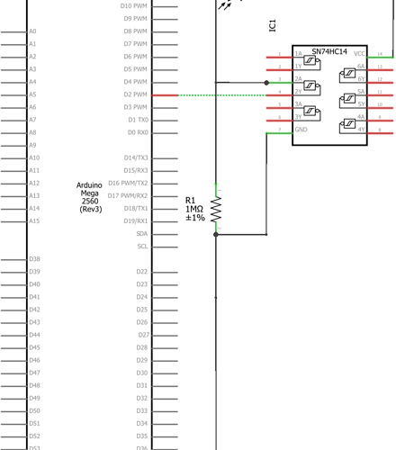

Currently developing a project using a Photodiode BPW34 and a Schmitt Trigger 74HC14, where light pulses hit the photodiode generating an interrupt, mostly of the system works, but there is a high probability of the below thing happens.

The Fritzing design:
Please post the code, using code tags. Also, avoid Fritzing diagrams. A hand drawn schematic is much better.
Please use better diagram than Fritzing. That's the info from ignorant sales people.

Thanks for the drawing. I hope it is wrong. Nothing is pulling the 2A input of the HC14 and the open collector output, 2Y goes to digital I/O D2. That's not doing anything good.
I don't know about any 74' Schmitt triggers with open collector.
A low pass RC filter would consist of a resistor from the diode to the trigger gate and a capacitor from gate to Gnd.

With ICs like the 74HC14, you should never leave unused circuit elements with open inputs. They will float, and the gates sometimes oscillate wildly. Always connect unused gate inputs to a known reference, like ground. You also need a 100 nF ceramic bypass capacitor across the HC14 power and ground.
You may be better off leaving out the HC14 entirely.

Also, if you have a spare 0.1µF capacitor, I would install it from the output of the BPW34 and GND. This will give about 0.1 sec time constant. Without it, the circuit will be very sensitive and prone to high levels of noise. The capacitor shouldn't affect the signal level per light level. May not need the 74HC14 if this resolves the problem.
Photodiodes are astonishingly fast so its no surprise you are getting multiple interrupts.
I'd suggest you use an RC filter to slow the response a little. Your 1M resistor will be fine, just choose a suitable capacitor - eg a 1nF will give you a 1msec time constant which would be a good starting point.
You need the schmitt to buffer the photodiode circuit as a digital input does not have a sufficiently high resistance.
Oh gosh, missed the part about "light pulses" and was thinking phototransistor. Typically a photodiode amplifier is needed ... here's one.

Please don't post false statements you could have trivially checked from the datasheet. The 14 is a hex inverter with push-pull outputs and schmitt-trigger inputs: https://assets.nexperia.com/documents/data-sheet/74HC_HCT14.pdf
Just on principle, I would have put the diode between input and ground and the 1M as a pull-up.

Is a try to make a weird optical fiber receiver, when a light pulse clock is detected, i read a sensor at the moment of a falling edge, i thought that interrupts were suitable to an application where i can't afford to lose information.
I tried using the capacitor (120pF and 470pF) as the same as in this topic (Schmitt trigger questions - General Electronics - Arduino Forum), with the Schmitt Trigger input, perhaps are you suggesting connecting a capacitor with the Schmitt input and output?

Bad idea to try serial I/O in an interrupt routine. It usually just hangs (Arduino is an exception). Set a global flag and leave printing to the main loop. Also, do not disable/enable interrupts within an interrupt routine.
No Scmitt input to ground. How fast are your pulses? I'd try a 2200pF - and as JRemington says, sort out your code.
