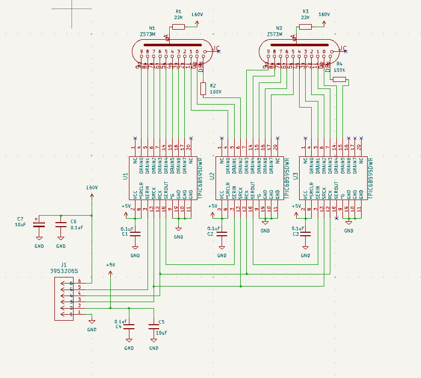

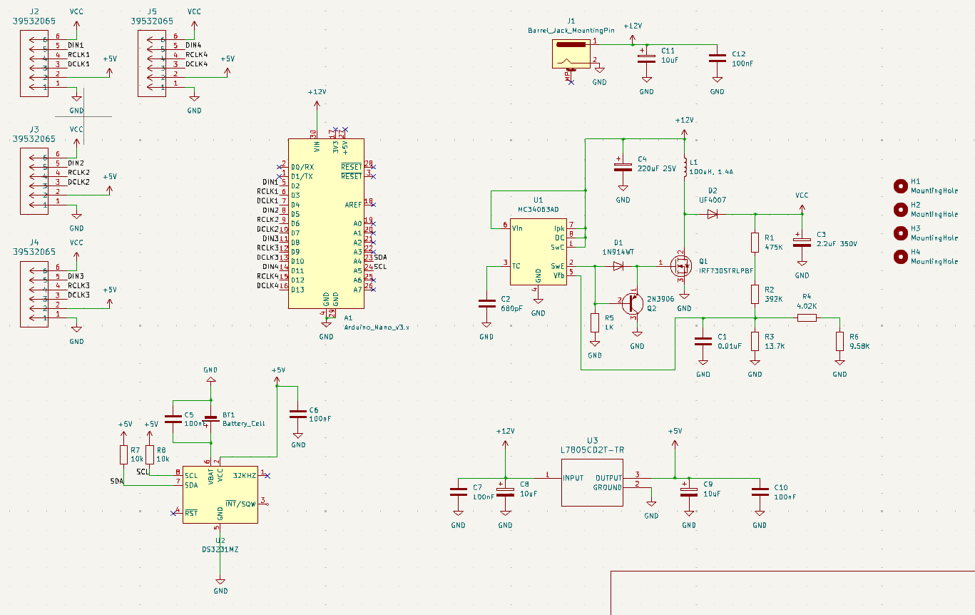

In very short words, I'm using my arduino to make a clock circuit. The arduino for the most part, is controlling the 'digits' using a TPIC6B595 shift register. There is also an RTC module that is connected to the arduino.
The circuit diagram is as below
The four 6-pin jumpers on the main circuit diagram (J2 - J5) connect to one PCB board containing the two tubes and 3 shift registers each. And there are 4 such identical PCBs
So basically, J2 goes to one PCB, J3 connects to another PCB and so on.

I also make clocks :slight_smile: and use a similar approach - several identical PCBs to control individual segments of numbers via shift registers. Only as indicators I use a flip-flop dot modules rather than high-voltage tubes.

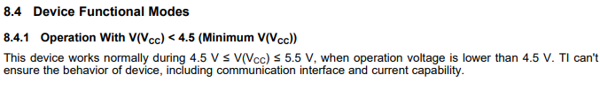

According to the TPIC6B595 datasheet , the minimum level of the high-level input signal corresponds to 0.85 of the supply voltage. So these registers need level converters for use with 3v3 logic.
Ah nice! Yeah it was more economic to make smaller separete PCBs since PCB manufacturers usually have a minimum number of PCB copies even if you only need 1 board. So this felt way cheaper.
Yeah, the high level logic voltage is 0.85 VCC for the shift register, and it made me wonder if I can use a 3.3v VCC for the shift registers and solve the issue that way. But of course, they DID mention the 4.2 V minimum supply voltage as well, so I'm just assuming the chip itself doesnt function at 3.3V. Because one thought I had was, yeah, I could just run +3.3V on the +5V signal mentioned in the PCB by using another linear regulator with the same footprint. (In the schematic that I attached, I'm using one that converts +12 to +5 as can be seen)
The only two devices that are using the +5V supply are the shift registers and the DS3231 RTC chip. And for this thing, 3.3V is actually ideal. But for the TPIC, I'm not entirely sure.
I do see this in the datasheet for the shift register, so it makes me think that using 3.3V supply for this thing might actually be ok. But they also say there's no guarantees, so perhaps I could take the risk and just pray that it sorts itself out
Alternatively, you can lower the shift register supply voltage to about 4.2-4.3v by adding a diode in series to the register supply circuit. In this case, the level of the acceptable input logic signal will also decrease and will be closer to 3.3v.
However, doing all these tricks, you enter the zone of unstable operation of the chip
It's a real shame you didn't daisy-chain/cascade those PCBs. If you had, a single level shifting board between the microcontroller board and the first shift register board would have solved the issue (and saved you 9 Arduino pins and lots of wire also, I suspect).
But now you will need 4 level shifter boards, or one board that can level shift 12 data lines.
You can use 74HCT245 as a level shifter for 8 data lines, so you would need 2x that chip.
