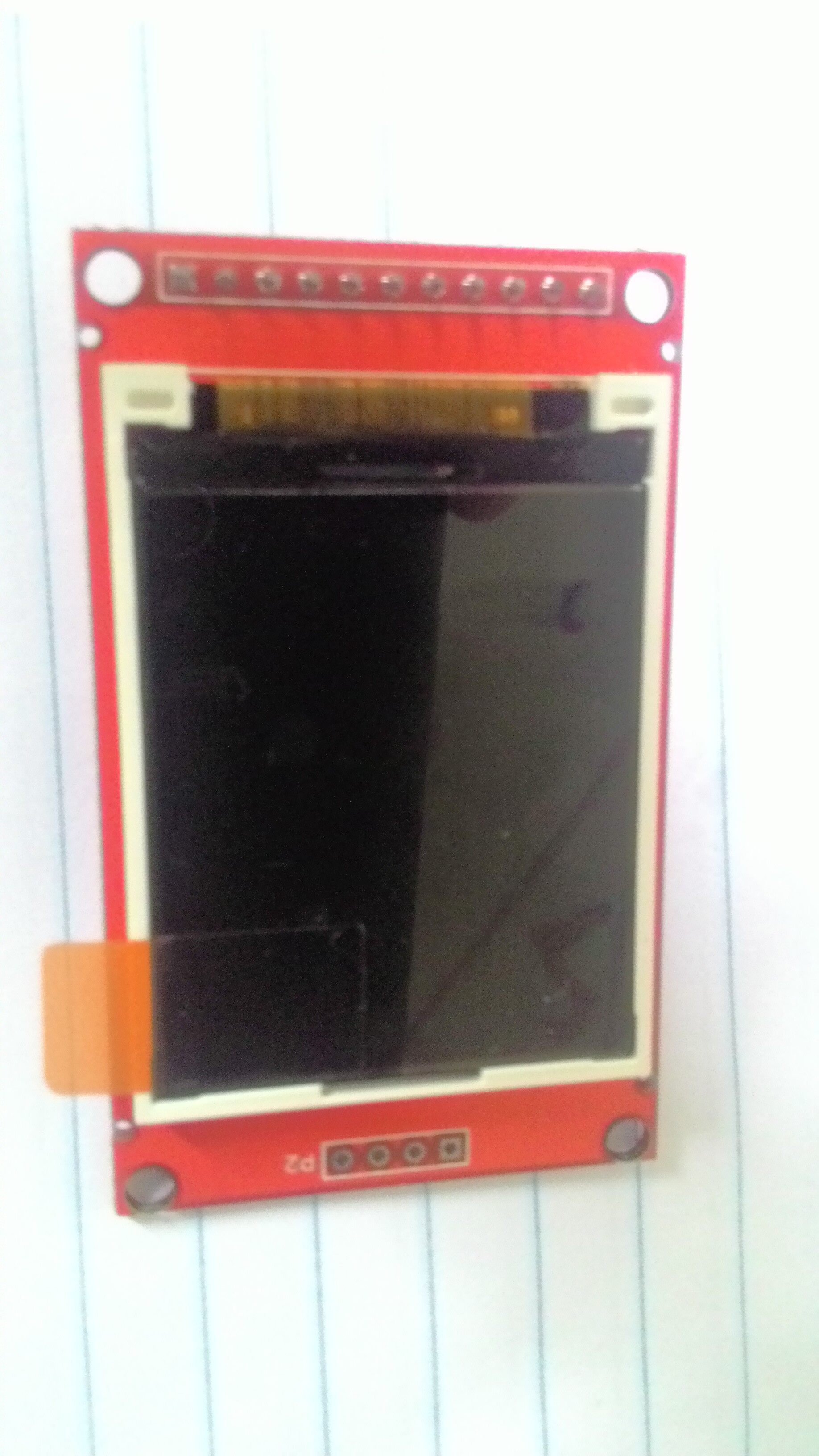

I'm have some struggles with the following device:
"1.8" Serial SPI TFT LCD Display Module ST7735B IC + PCB Adapter For Mega2560 R3"
I newer in arduino and buy this item from ebay. The pin configuration of the display does not match with any which i found in the web, can you help me with the identification?

but i get this pin distribution on my display
  1. VCC
  2. GND
  3. GND
  4. NC
  5. NC
  6. NC
  7. CLK
  8. SDA
  9. RS
  10. RST
  11. CS

but i have no LED pin, instead i have a NC in place.
I would like the help of some one of you to identify the pin configuration and the advice for some reading material relevant to understand how to manage this display.

I have never seen a ST7735B. Has anyone got a data sheet?
The reason for your "unusual" pinout is so that you can plug it directly into the Power & Analog headers e.g. 5V through to A5. The main attraction is that it will work with 5V logic from a MEGA2560.
If you bit-bash SPI in software, the display will work fine. Unfortunately the HC245 chip is wired as unidirectional. You can only write to the TFT. You can't read SDA pin.
If you want to use hardware SPI, you would need to hand-wire all the pins to the 3x2 SPI header instead of a nice plug-in.
David.

I have a similar display but with an ILI9225. pin#6 is LED on my shield.
I suggest that you install the Adafruit_ST7735 library. And use this constructor:
//Adafruit_ST7735 tft = Adafruit_ST7735(cs, dc, mosi, sclk, rst);
Adafruit_ST7735 tft = Adafruit_ST7735(A5, A3, A2, A1, A4);
And switch on the LED with:
    pinMode(A0, OUTPUT);
    digitalWrite(A0, HIGH);
Plug the shield into your Uno, Mega, ... with the CS pin mating with A5. Build and run the Adafruit examples.

Thank You so Much,
The display is running very well, I will try to enable the SPI pins in order to use all the capabilities.
