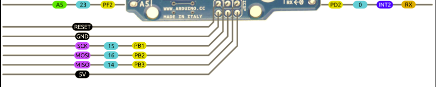

I´m trying to find a conection schematic about MicroSD module to Arduino Micro. I see a lot of schemas on Internet in other models of Arduino (UNO, MINI, MEGA...). But I did not see to Arduino Micro.
Please, if any of you have it, post an answer with a photo or a explication about that.

the microSD module connects to the SPI pins of the Arduino. and requires power.
Have a look at the pinout
and you will see those pins at the bottom.
The unit i have takes 3.3v power and logic, but you will need a 5v version, with regulator and logic-level converter since the micro will run at 5v

The SPI pins on the Leonardo are on the 6 pin header.
Or check the schematic : https://www.arduino.cc/en/uploads/Main/arduino-leonardo-schematic_3b.pdf
