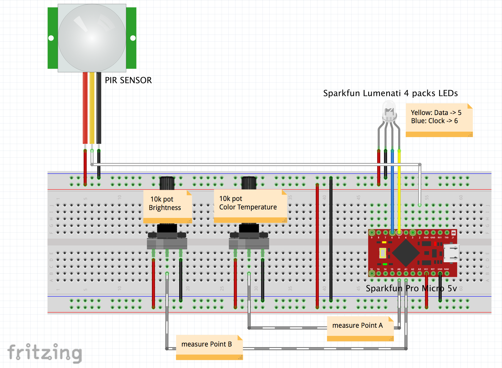

I'm having a limitation issue with the following project, where if a brightness pot sends more than 4.37v, the circuit doesn't behave as wanted.
parts: sparkfun pro micro, PIR motion sensor, Lumenati 4packs leds device and 2 pots (10k) for brightness and color temperature.
Imported Libraries: FastLED.h and Kelvin2RGB.h
Measurements are made with a cheap RadioShack digital multimeter.
Brightness pot values are mapped as map(0, 2013, 0, 255)
Color temp are set in Kelvin and pot values are mapped as map(0, 1023, 0, 7000)
Using kelvin2Rgb lib to then convert the 0 to 7000 range to 0-255 rgb values for leds.
at 2682 kelvin (pot2), but also at higher or lower color temperatures :
Brightness pot (pot1) set to 4.42v (measured when leds are ON) seems to be the limit.
It goes from 4.42v (ON) to 4.43v (OFF)

If pot 1 (brightness) delivers more than about 4.50v, Leds will turn back ON after a short blink instead of staying off (time limit for lights on after motion is detected)
If i remove the pots and hard code the brightness, even up to max value (255), it works fine.

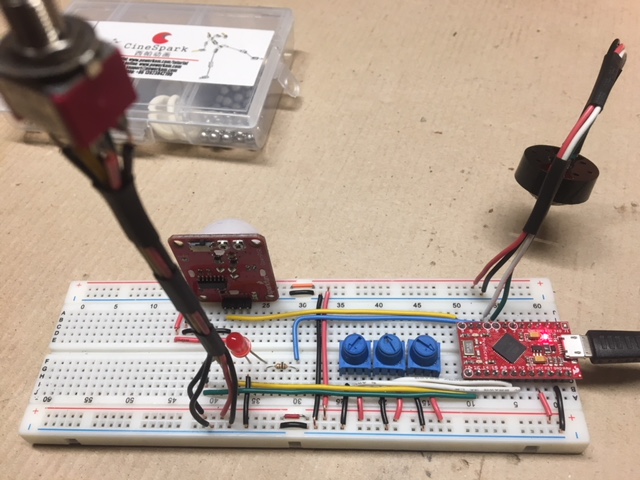

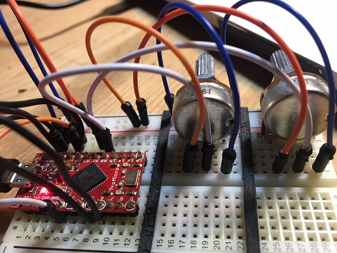

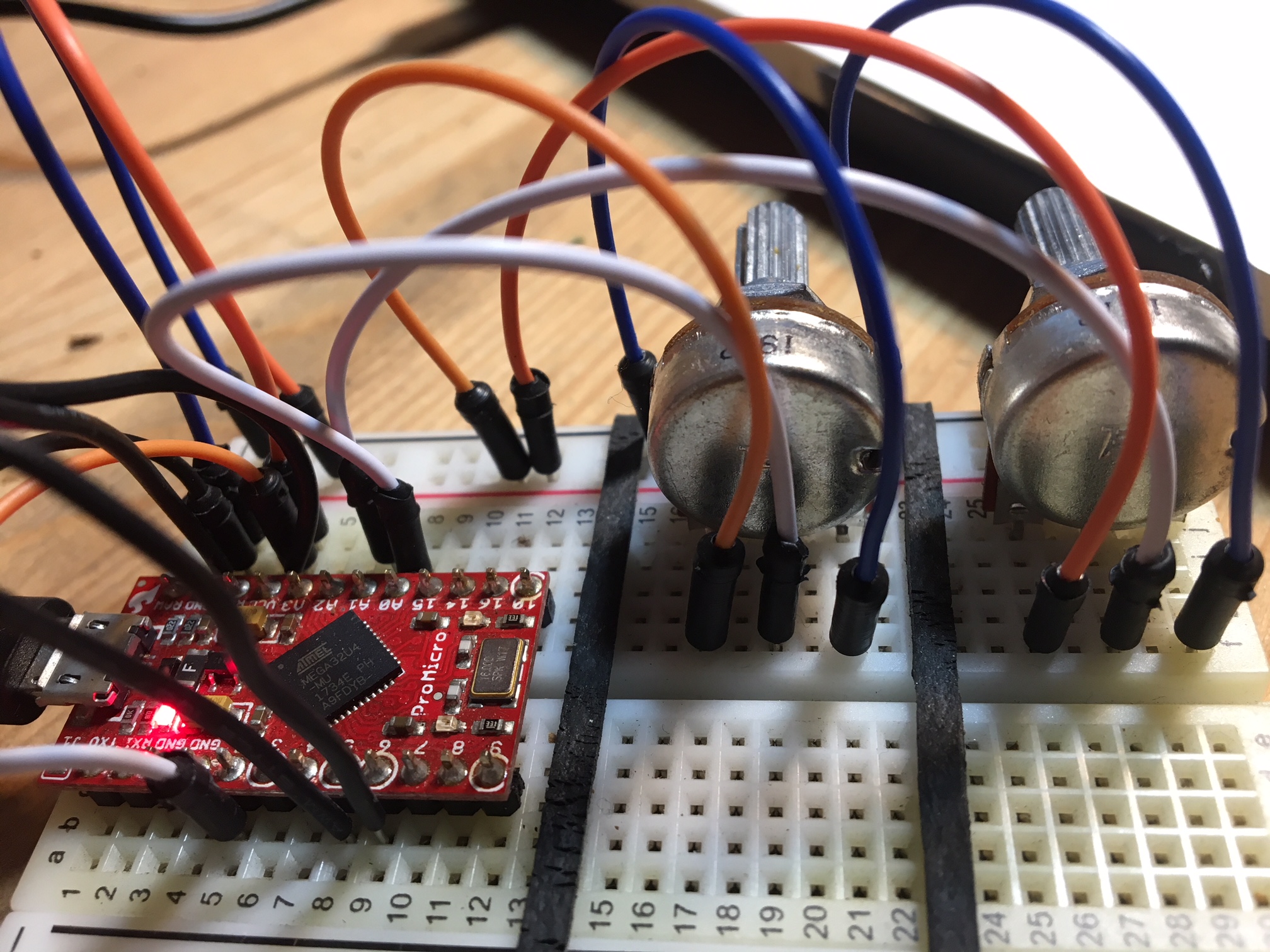

Anyway, i sorted it out, not fixing what i had but starting clean from scratch with different PIR and pots.
The attached photos work with the latest code, i didn't update the fritzing which is only missing the switch. The rest is un-changed.
