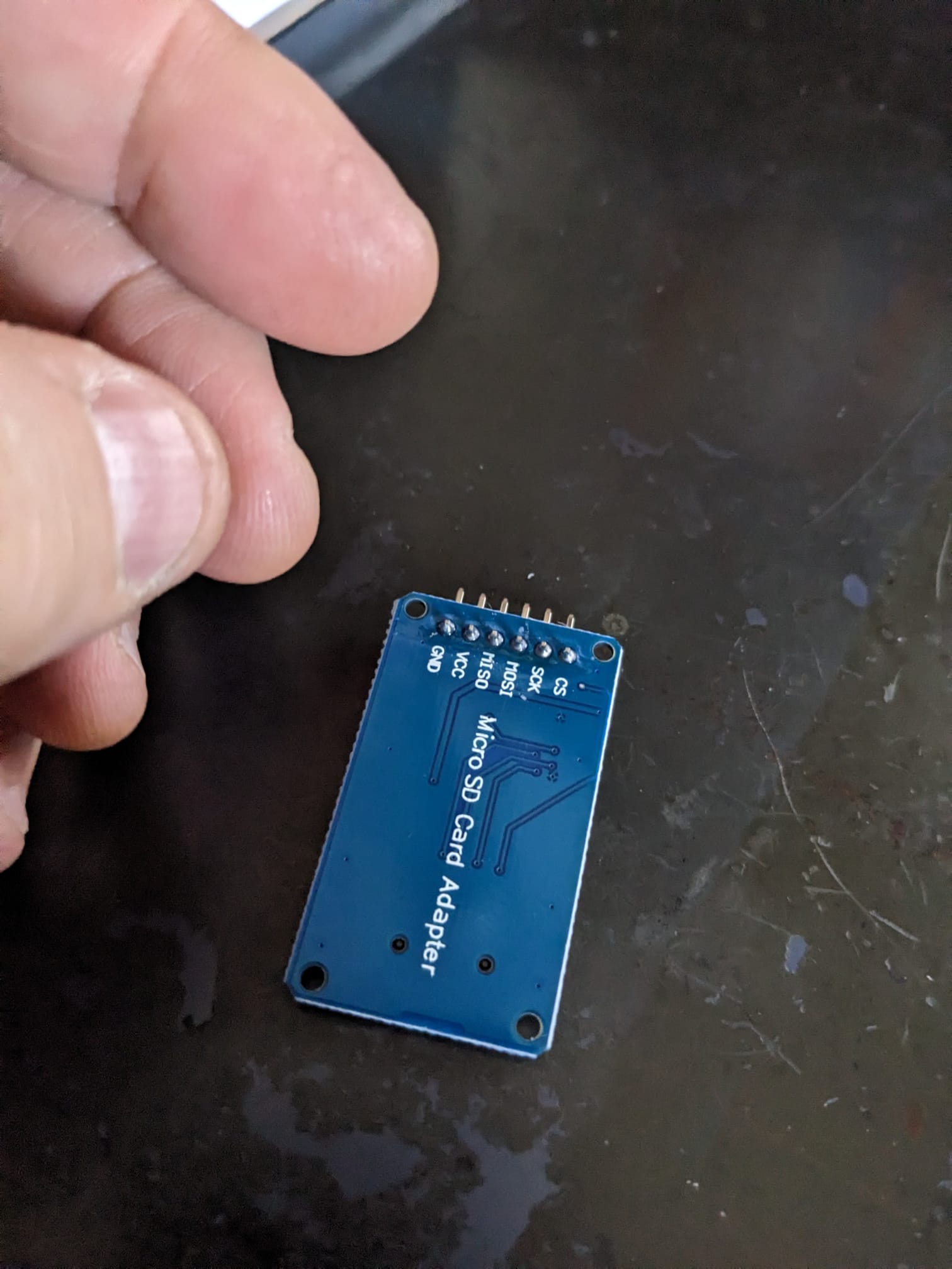

I attach the sd card reader I'm using
You should not fiddle with pin 13 when using a SPI device like your card reader on an Uno.
I don't say it's the cause of your problem (I simply don't know for sure) but pin 13 is part of the SPI interface of boards like Uno and Nano.
Try without controlling the LED and see if it improves.
