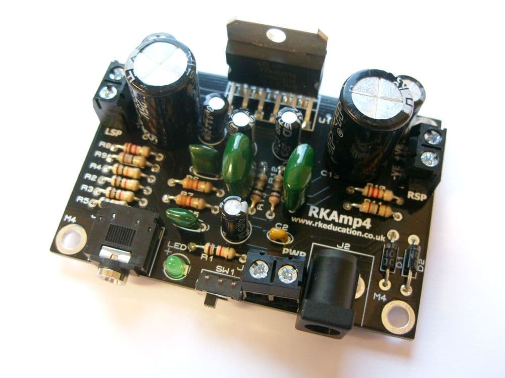

I had this in mind for the amplifier stage,
http://rkeducation.co.uk/RKAmp4.php
I am planning on building a mini speaker, should sound awesome!
