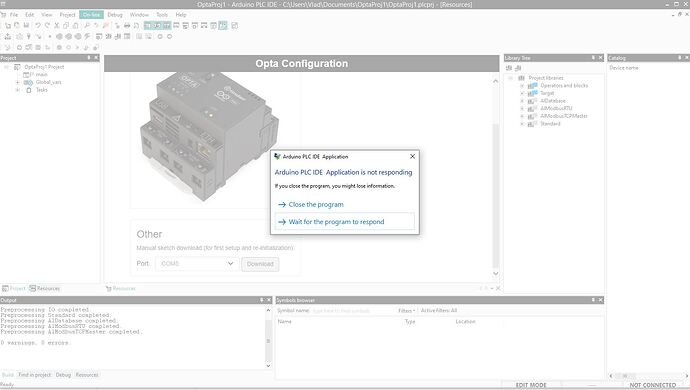

I first downloaded the Arduino PLC IDE (latest) and tried to connect to the controller. I created a project, selected the right COM port (verified 10 times), pressed "Download" and selected On-Line > Connect. The IDE crashed (see attached image).

Oh, since there have been reports of this problem on older versions, I am running 1.0.3.1
IDEcrash2
Did you ever figure this out? I am having the same issue with v1.0.7.0.
This issue happen because the first connexion to the "PLC" are very tricky.
So:
1 Double tap the reset button
2 Go to resource and click on Opta
3 Download button and check the serial
Port
4 Check again the license are Ok
5 Check on output the new serial Port
Try download if the issue remain try again at point 1
After 3 times take one hammer and destroy it
