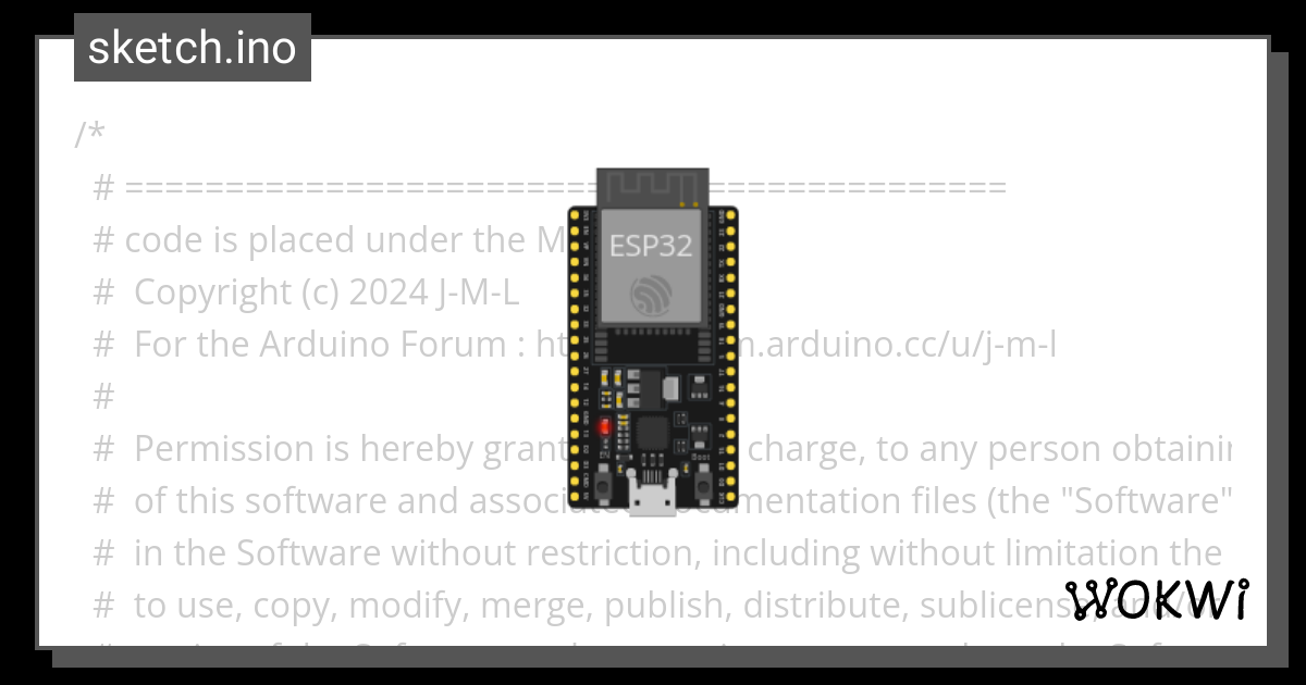

actually in the free version an ESP32 can join a wifi network with
  WiFi.begin("Wokwi-GUEST", "", 6);
so you can do stuff
the paid version has more capabilities

yes I've used it to write demo code getting a JSON from an on line service for example or recently demo how you can get time from an NTP server (for the French speaking forum)
