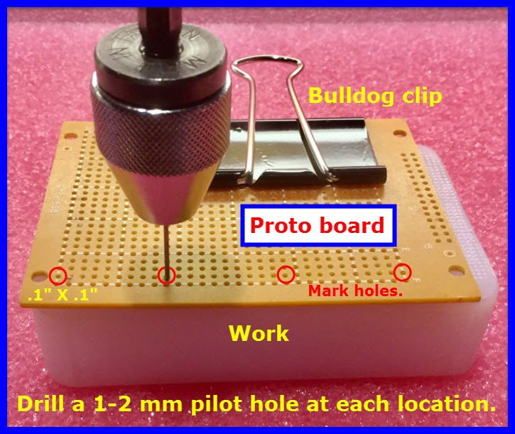

You did see this:
Use a proto PCB as a drill index.
https://forum.arduino.cc/index.php?topic=445951.msg3162903#msg3162903
If you want a kit there's this:
but it should be easy enough to DIY.
I actually made one by heating up the plastic of a 2x3 IDC connector a little with a heat gun a little and then pressing the pogo pins into the holes (not big enough to fit the pin without softening the plastic. The pins wiggled around in the connector after that so I used some hot glue to fix them in the correct positions. That made a very minimal ICSP POGO cable for programming boards that didn't have ICSP headers soldered. of course the circuit board/soldering approach is the way to go for a test jig.
