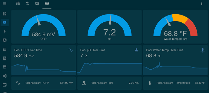

I’ve begun work on a system that will send pH, ORP (oxidation/reduction potential), and water temperature data from my pool to my Home Assistant instance at regular intervals, inspired primarily by “raspipool” (GitHub - segalion/raspipool: Swimming Pool Automation Systen with Raspberry Pi + Home Assistant). I went a different way with the primary hardware and have an Arduino Uno Wifi rev2 board instead of the RPi. To test the setup of communication between the Uno and Home Assistant, I set up MQTT sensors, input_number helpers, an automation to translate the MQTT values to the input_numbers, and a dashboard in HA, and wrote a “mock” service that sends randomized data (within specific parameters so it’s not all over the place) from the Uno to the MQTT topics. The dashboard receiving the mock data currently looks like this:

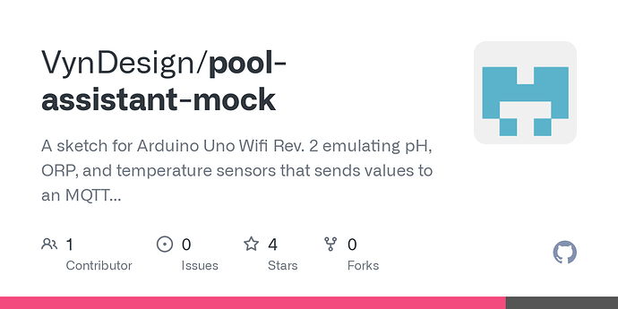

A full write-up of the configurations I found necessary, as well as the Arduino code is at:
I already have all the other components - the “Whitebox T2” shield, the EZO circuits, and related probes, but just ordered still need an enclosure and some other support hardware in order to flip the EZO circuits to I2C mode (they come factory-programmed for UART and the T2 only allows for I2C), and of course I need to build the plumbing necessary for the probes to actually do their job reading the pool water. But I’m glad to have the proof-of-concept already running. For the next iteration, I will attempt to tackle all of the “future vision” bullet points:

Thanks, yeah, it's been fun researching, coding, and assembling the hardware necessary to do this. I still have more to implement than just the probe rig, the code linked in my post is a "mock" service that currently "mimics" the results of the probes and hardware interpreting the data, so I still have to write the actual code to take the readings from the probes.
I have just assembled the hardware - the Uno Wifi, Whitebox T2 shield, and the three EZO circuits for the temperature, pH, and ORP sensors. I plan to post a video of the process to switch the EZO circuits to i2c mode from UART mode and the assembly of the components.
If you take a look at the GitHub link in my post, it contains the code for the Arduino as well as a readme that details the Home Assistant setup and hardware components list.
