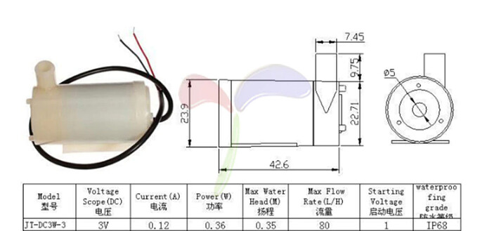

The pump is a submersible 3V. https://cdn-shop.adafruit.com/product-files/4547/4547_C144374-001+vertical+pump+specs.jpg

Can you post an English data sheet please? English is the correct language for this section of the forum, so that data sheet is not very useful. Even the English text in it is blurry and difficult to read.

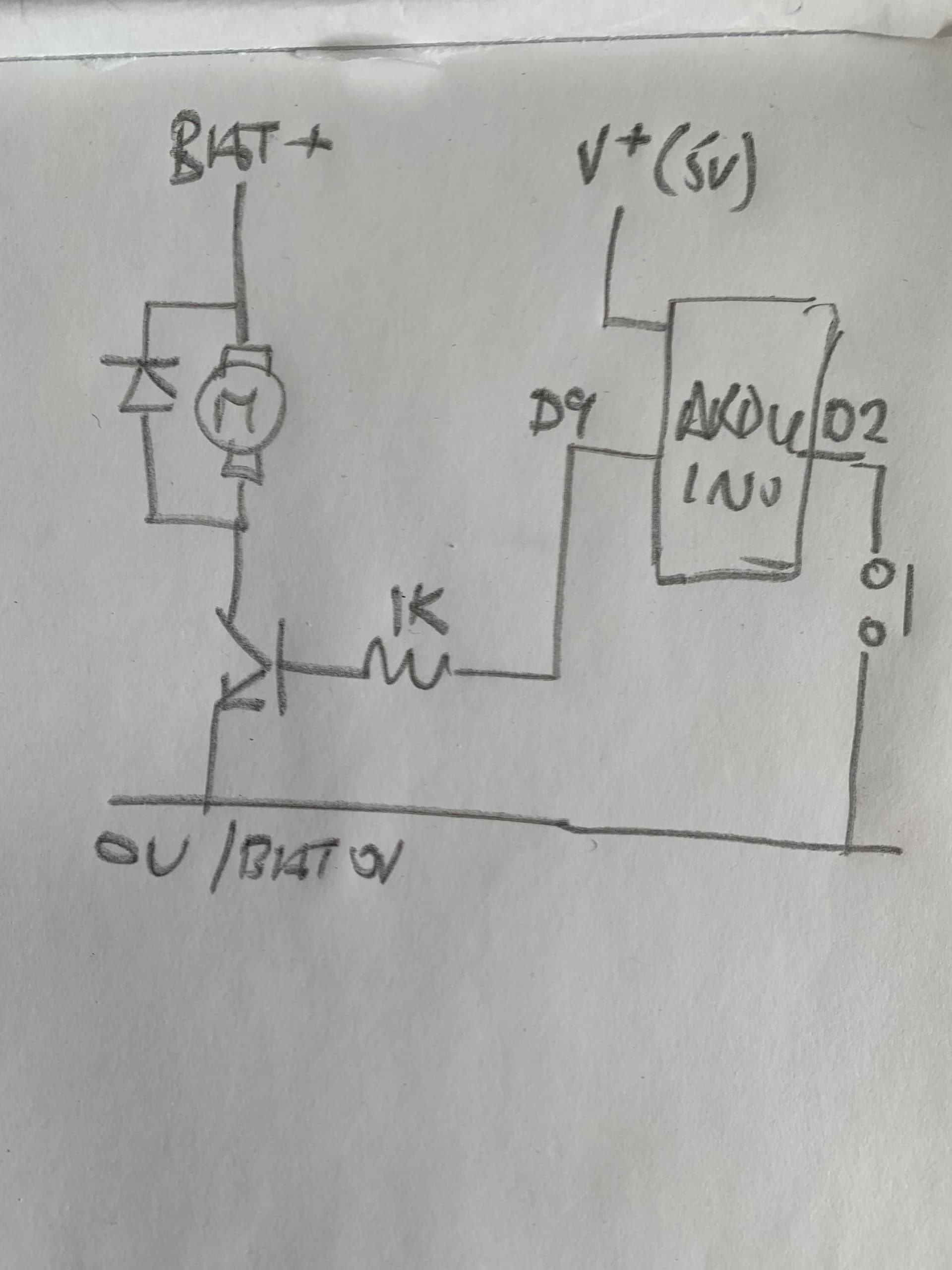

Would this schematic work?
Never drawn one before by hand so i will have to figure, please stand by.
Hope this can help.
No, as mentioned, the 9V battery is unsuitable. Also the flyback diode does not seem to be correctly connected, but it is a little hard to tell because the wiring is like spaghetti. Position the components on the schematic so that the length of the wires is minimised and crossed wires are minimised.
Re-read the earlier answers you got about where resistors are and are not needed.
Not much. As sometimes happens, an important figure is missing, which is the stall current. Use a multimeter to measure the motor coil resistance. You can work out the stall current from that.

This is the sort of hand drawn “quick” schematic people ( hopefully ) want ; note +ve supply at the top , Ov at the bottom . It’s simple to read and understand . Put a blob on wire junctions , I like to put a jump over crossing wires .
“INPUT_PULLUP” used on the switch line .
I think this is how your circuit should look .
Please don’t waste your time with that 9v battery
Drawn by Paul , aged 7.
You will see some schematics with positive supply on the left and 0v on the right , that’s ok too, some with signal flow from left to right and power supply top and bottom . A long as it’s logical that’s fine .( did mine with signal flow right to left ( I’m left handed lol )).
You can do good schematics with Fritzing , using schematic NOT Breadboard
