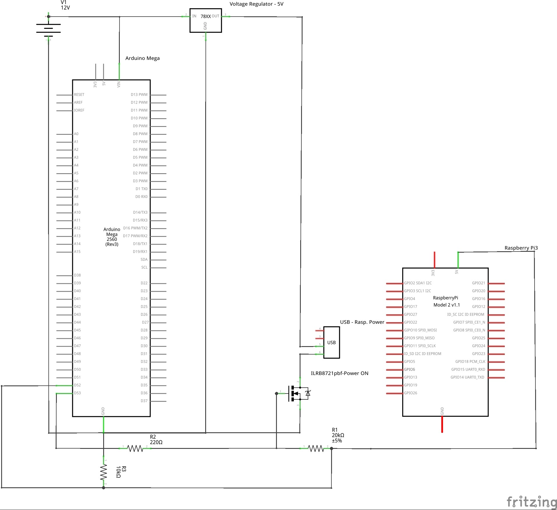

as a part of my project I need to control the power on and shutdown of a raspberry pi 3 with a momentary button, using an arduino mega. My idea is to use the circuit in the picture.
The main power come from a pico psu (12 V) and it is converted to 5V by a step down voltage regulator, not exactly the one in the schematics, but one of this.
The power on circuit is controlled by a IRLB8721pbf mosfet with the gate connected to the arduino pin 53 and to a pull-up resistor (R1) connected to the +5V GPIO PIN of the raspberry pi that will prevent the shutdown of the raspberry when arduino is resetting or when flashing a new sketch (floating PIN).
The 5V PIN of the raspberry is also connected to the arduino PIN 52, in order to check the state of the raspi.
About this part of the circuit I have 2 doubts:
  1. Is the voltage drop caused by IRLB8721pbf small enough for the Raspberry pi (Rds On =8.7 mOhm@10V)? Datasheet here
  2. Is safe to connect directly the +5V GPIO Pin of the raspberry pi to the arduino PIN 52 (configured as input PIN)?
The second part of the circuit is for the shutdown and it is based on this tutorial
Basically is a python script on the raspberry that set the GPIO pin 13 as input with the internal pull up resistor turned ON and when this PIN is shorted to ground a shutdown command is executed.
As for the power on part, the circuit is controlled by a IRLB8721pbf mosfet with the gate connected to arduino pin 50 with the help of a pull-down resistor R5 in order to prevent accidental shutdown.
My doubt here is if it safe to connect all the ground (+12V line, +5V line, Arduino GND PIN, Raspberry GND PIN) to the same bus.

I think most people will find that diagram very difficult to read, it made me feel dizzy.
Do you have a schematic, that woould be much easier to read ?
Why use a 5V regulator when you already have the picoPSU?
Why did you pick that particular MOSFET?
Why use an Arduino for something as simple as a latch?
  1. Check the peak current draw of the RPi, use Ohm's law to calculate the voltage drop over RDS.
  2. Obviously not. The RPi's IO are only rated for 3.3V, 5V will destroy it.
Please post a circuit diagram.
Ok this is the schema.
In order to make it more readable only the "power-on" section of the circuit is reported
I don't think you want to disconnect the ground on the Pi with a MOSFET, I think it is better to stop the power from going into the 12V to 5V converter.

As @ron_sutherland has pointed out, switching the gnd will not remove power from your Pi.
You have inputs and outputs on the Pi that are connected indirectly to gnd and the Pi circuitry will draw current through your I/O.
High Side switching as he has suggested will make sure the Pi is properly isolated.

@ron_sutherland and @TomGeorge, thank you very much for your useful suggestion!
So an upside switch before the voltage regulator is a better idea for proper isolation and here is my new schematic for the power-on section.
As a suitable P-MOS I have found this FQP27P06 that seems to be adequate (RDS(on) = 0.07Ω @VGS = -10 V and VGS Th = -4.0V), but is there something better?
Because I don't have yet the components to to test the circuit directly, I have tried a simulation (very ugly drawn, but works :slight_smile: ), visible here (close one of the two +5V switches to see what happens when powered on).
All seems to works fine, and, after some trials, I have found that increasing the value of R1 to 1MOhm reduces the amount of power wasted through the N-MOS branch of the circuit... But is this resistance value to high and, as a consequence, sensitive to some noise?
P.S.: The scope of R6 is to keep the gate of the N-MOS closed when the Raspi is off and the Arduino is booting
You need to add some capacitors around te 7805 regualator, for stability and regulation.
Look at the data sheet for a LM7805 for details.
Tom.. :slight_smile:

Fine mate, just put a 0.1uF capacitor across the output wires to help with bypassing.
What is the purpose of R5, 20K and the connections to D25?
Tom.... :slight_smile:

I have only a +12V line in coming from a very common power supply like this, that will supply both arduino and the raspi
The scope of R5 is to keep the gate open when the arduino is booting or resetting. I need this feature because on the raspi I have installed avrdude (to compile and upload sketches) and I don't wont that the raspi shutdown when arduino is resetting. It is not reported in the schematisc but the raspi and the arduino are also connected via usb and exchange data via serial port.
The scope of D25 is to check the status (on / off) of the raspi and display it through a RGB led associated to the momentary switch (a capacitive switch will be very cool!) that triggers the power on / shutdown of the raspi.
However I'm not sure that this will work with the +5V gpio pin because, according to this post , this pin is always powered also when the raspi is in shutdown. Probabily for this purpose I need to use the UART TX pin (+3.3V)

Because of the fact that this is a digital circuit and among other things your power supplies are switch mode, there is the possibility of switching noise occurring on the 5V rail, this can cause glitches in the execution of your code and any voltage sensitive devices.
The 0.1uF capacitor placed at suitable places in a circuit, the caps filter the noise out.
