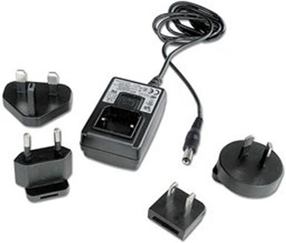

I have a project that involves 3 boards and I want to power them up using a single power source (that I will buy, dont have it yet):
1) Arduino Uno: 6-12 Volt recommended, lets say 250mA
2) GSM modem board, 5V, 2A in peaks (!)
3) Raspberry pi, 5V, 1A
It there a way to power them all using one adapter?
And is there a ready to buy solution to take care of the voltage difference for the Arduino?
Whats your experience?
When you have a stable solution for 2) and 3), you can easily feed the Arduino from their 5V too.

Best bet for that amount of current draw is a small ATX power supply. The kind of thing you find in small 1U servers.

Ok, I realiseI can use 5v external supply for the Arduino as well. I was reading about the recommended 6v-12v.
Ok then I have no problem:)
As for the adapter I will use a normal one:
e.g. in UK
http://www.amazon.co.uk/LINDY-2-5mm-Country-Switching-Adapter/dp/B005NF4C7O/ref=sr_1_9?ie=UTF8&qid=1343918592&sr=8-9
I believe this to be sufficient, because all current numbers are for peak levels. So I am 250 mA short if all boards peak at the same time. I will give it a try.

You should be ok, the Pi is only around 750mA, not 1A, so that covers your extra 250mA.

Of course, this is cheaper, and gives you an extra 600mA headroom:
http://www.rapidonline.com/Electrical-Power/Stontronics-5V-3-6A-15W-Desktop-Switch-Mode-Power-Supply-Unit-T3321ST-90-2595
You have delivery on top though unless you get past their minimum order level for free delivery.
I don't see the extra 600 mA :
From their specs:
can provide up to 15W
This is max 3A @ 5V . You won't really benefit from a drop to 4V when taking 3.6A ( before it completely switches off ? )
I guess they're pretty similar.
