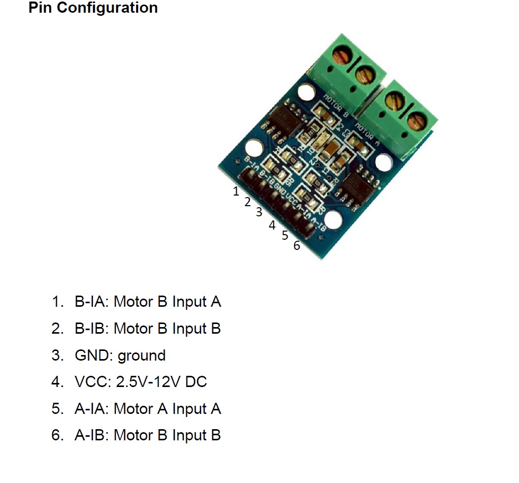

So I am currently planning a project where I have 3 linear DC actuators controlled by an arduino by using L9110s to modulate the speed and direction. My question is will the L9110s function normally if I am giving them power externally at 12V and then using a 5V pwm from the arduino to control them, will this work? or will the L9110s not behave properly if it is receiving different voltages at the power and the signal. I am quite new to electronics so please correct me if I have made wrong assumptions and any help is appreciated, thanks

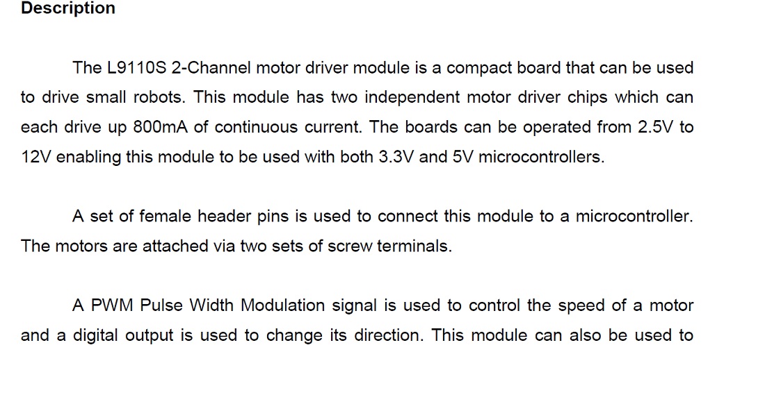

Actually the L9110 datasheet is awful, the VIL and VIH entries make no sense at all, so I'd couldn't hazard a guess. Its not even clear if the 12V is the abs max supply voltage or the maximum operating voltage.
I would say that 12V is the maximum supply voltage for the IC.
This it seems means if you have a supply that is greater than 5V, it will accept 5V logic on its input pins.
Note you loose 9 - 7.6 = 1.4V across the controller.
At 650mA stall current form the motor specs.
1.4 x .65 = 0.91 Watts dissipation in the L9110 for EACH half of the h-bridge.
So total dissipation = 2 x 0.91 = 1.82Watts.
You may feel a bit of warmth from the chip but it is within specs of 800mA continuous.

That's not precise enough - is it the "absolute maximum never exceed", or the maximum recommended operating voltage, or something else? The whole datasheet is poor/incomplete, no doubt partly lost in translation...
You never run a chip at its absolute maximum voltage, but you usually want to know what it is so you can evaluate the safety margin in the design.
For instance if you know the absolute maximum to be 14V, you can't use this chip with a SLA 12V battery, but if it were 16V you can...
