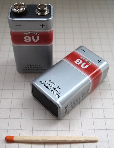

Is not a real battery!
I beg to differ. I use 9V PP3 smoke alarm batteries for many arduino circuits because UNLESS you are trying to power an INDUCTIVE device like a solenoid or large motor, it is fine. I recently used it to power a small 1.5V dc motor powered by an L293 to verify an OP's circuit. He said it didn't work. I found an L293
IC in my parts bins , wired it up and it ran just fine using the 9V battery to power the motor power pin of
the L293. Also, most of the arduino circuits I build do not need to run more that 30 minutes as that is all
it takes to verify the circuit. An arduino UNO draws about 55mA max and a smoke alarm battery is rated
for a minimum of 300mAh so regardless of where you got the battery or what type, you can almost certainly get at least 5 hours of operation for an arduino circuit, especially if it just involves sensors and
a few leds. Yes, they're useless for most motor/solenoid applications but using one of

That may be but this is a question about multiple solenoids, for which a PP3-sized 9V alkaline battery
is assuredly a poor choice. And this is about current draw, nothing to do with inductance per se.
NiMH rechargable 9V batteries can provide a lot more current typically, but without knowing
more about the solenoids there's no decision that can be made.
It does sound like 9V is too much, and that the current requirement for all 5 is well beyond
a typical 9V.

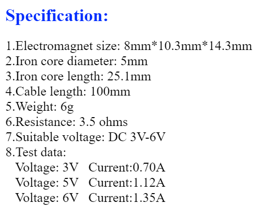

The specifications for my solenoids are below.
3V at 0.70A
5V at 1.12A
6V at 1.35A
Resistance: 3.5 ohms

You are misinterpreting the EBAY listing. Your solenoid will operate with any one of the voltages you listed. The difference is: what pull does the solenoid need to supply and more important, how long does it need to supply that pull?
IF you need more pull than the 3 volts delivers, then you need to power the solenoid with 5 volts or even 6 volts.
If you need the solenoid to pull for a long time, it will likely get warm and you battery will also be discharged.
So, what is the application you are working on?

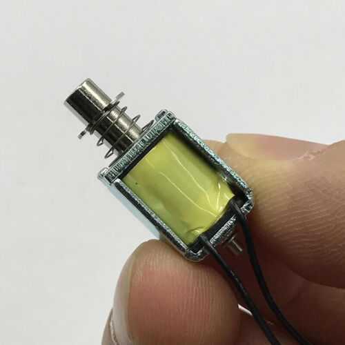

PS, the spring return on the solenoid shows it is not a "push-pull" type, but a "pull only" solenoid.

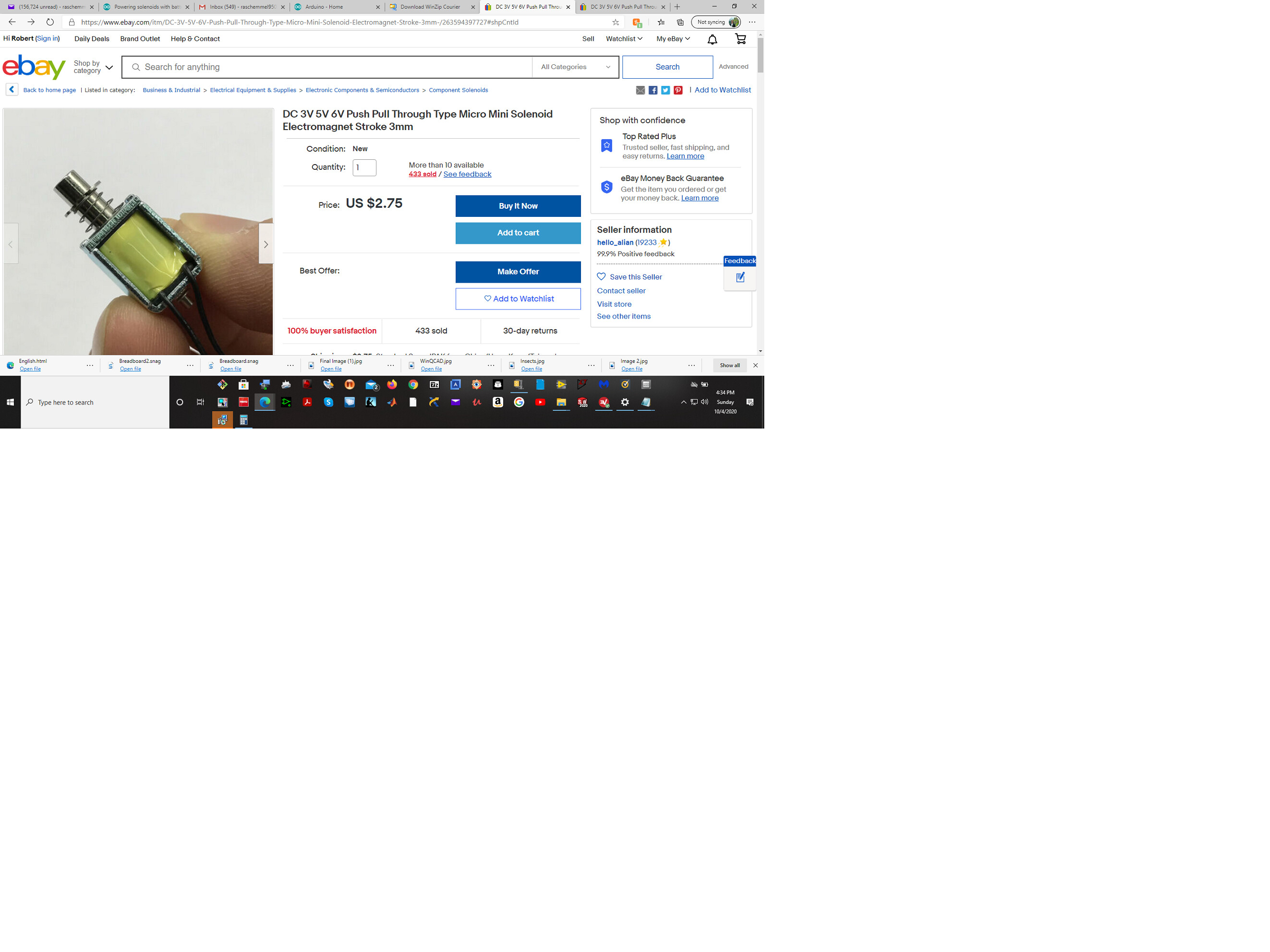

I didn't see ANY specifications at that link. Take a screenshot of the specifications and post it.
raschemmel:
Don't need to!
Scroll down the page a little, then pull down the slider you see. ![]()
You evidently don't use eBay much. ![]()
I am using the other side of the solenoid (side without the spring) for push functionality rather than pull.
I do not need very much strength as I am using them for a ratchet mechanism and they just need to reach the 3mm length in order to push in a very weak pawl.
Time is much more important for my application as they may need to stay powered up to a minute.
What slider ? I don't see any slider.
Can you just pull down the slider and take a screenshot of the specs ?
You just have to scroll to the bottom of the page.

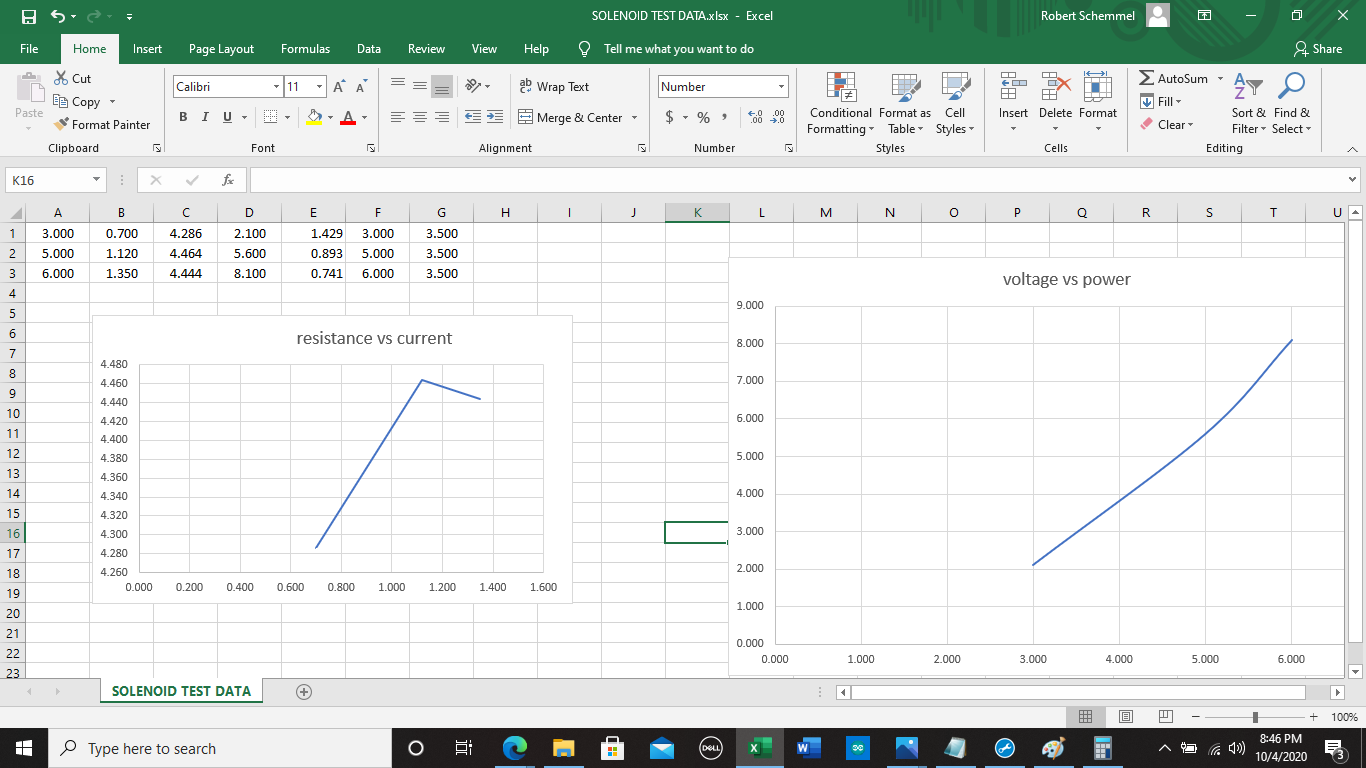

That is simply a representation of the relationship of current to voltage.
There is only ONE spec: coil: 3.5 ohms
The voltage is just a rating (3 to 6V). Technically it is a spec but the critical item is the coil resistance.
Plot on the left shows the resistance is a flat line
Plot on the right shows the power dissipation in Watts is a function of voltage. (and it is almost linear)
What this means is that the 'SPEC' (SINGULAR) for your solenoid is 3.5 ohms @ 3 to 6V.
The reason it is singular is that the current at the higher voltage is no different than the current at the
lower voltage
Note that resistance is a function of temperature and temperature is a function of current.
Also note that the resistance calculated using voltage and current only varies by 5%
4.286 ohms
4.464 ohms
4.444 ohms
raschemmel:
Oh really!
Here is the frame with the slider!
