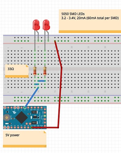

I am new to both Arduino and EE, and am currently working on a multi-faceted project. One of my needs is producing a lot of light in a small space, and so two 5050 SMD LEDs seem to fit the bill. They can be controlled from a single pin since they will operate in unison.
The LEDs have a forward voltage of 3.2 - 3.4V and are 20mA (60mA total per SMD).

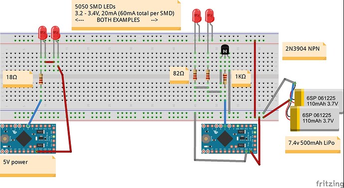

I am looking at powering the LEDs either with 5v from my Arduino or from the 7.4v power source available to my project. I've created breadboards for both options [JPEG is attached], and am looking for feedback from wiser members of the community on both approaches. So, please, take a look and let me know if you see any problems with my work.
Thank you!
Hello, can you explain again how you calculate that 60mA figure?
Your circuit on the left will probably not work. 5V is not enough to light the two leds in series. Can you explain how you chose that series resistor ?
Your circuit on the right looks ok at first glance. You may be able to wire the two leds in series because 7.5V might be just enough.
Paul
Hi Paul, thank you for your feedbacK! The 60mA comes from the datasheet. The 5050 LEDs have three LEDs, each one using 20mA.
For the left hand circuit I made a mistake, and calculated with 7.4v instead of 5. Using the correct voltage (and your advice about not running the LEDs in series), I have come up with this new circuit.
What do you think, will this one work?
With that circuit, each led will draw (5 - 3.3) / 33 = 51mA
So the Arduino pin will be required to sink 102mA, which is more than double what it is rated for. It will probably be damaged, sooner or later.

Thanks Paul. I was under the false impression that I could get around the 40mA current limitation by sourcing from the VCC, and sinking with the pin.

I think wiring the two leds in parallel, using the npn transistor and the 7.4V supply might be your best plan.
Wiring them in series would mean a forward voltage of around 6.6V for the two. The transistor might drop as much as 0.7V. That would only leave 0.1V to be dropped by the series resistor, which is too little for it to work effectively and protect the leds. And when the cell's voltage drops a little, the leds might switch off, forcing you to recharge them when they still have plenty to give.
Wiring the leds in parallel could be done with 5V supply and the transistor, but would put an unnecessary load on the Arduino's regulator.
For wiring in parallel, assuming the transistor drops 0.7V, the series resistors should be (7.4 - 3.3 - 0.7) / 0.060 = 57R
It never occurred to me to calculate the voltage drop of the resistor [oops I meant to say transistor - sorry] when I did the math, so thank you for that. Can I ask how you determine what the drop is? Is it a standard value for the 3904, or based on the source voltage?
0.7V is a typical voltage drop for most ordinary npn transistors.
Wait a moment... i misread your post. You are asking about the voltage drop of the resistor not the transistor. I didn't expect that! I have no idea how you have been choosing the value your series resistors without understanding how to calculate this.
Resistors follow Ohm's law. The voltage drop accross them is proportional to the current flowing through them. Leds and transistors do not follow Ohm's law. They were not invented when Mr Ohm was alive. Their voltage drop is more-or-less the same for any current in the range they are normally expected to work with.
So you need to subtract those fixed voltage drops off the supply voltage. Whatever is left will be dropped by the resistor. To calculate the resistor for value to allow a desired current to flow, use Ohm's law R = V / I.

Ok, thanks. A base current of one tenth of the collector current is possible for the OP's circuit. The emitter current is only around 120mA and a base current could be 12mA from Arduino pin. Does this mean the voltage drop Vce will only be 0.2V? If so, is that the best solution? The OP's circuit has enough headroom for a higher Vce, so could a lower base current be appropriate?

Using the 0.2 voltage drop, Ohm's law suggests a 65 Ohm resistor. I have 68, so have used those in my circuit. The LEDs are bright and I am comforted knowing that I am not placing a strain on the Arduino pins.
A big thanks to you gentlemen for your guidance with this circuit.
