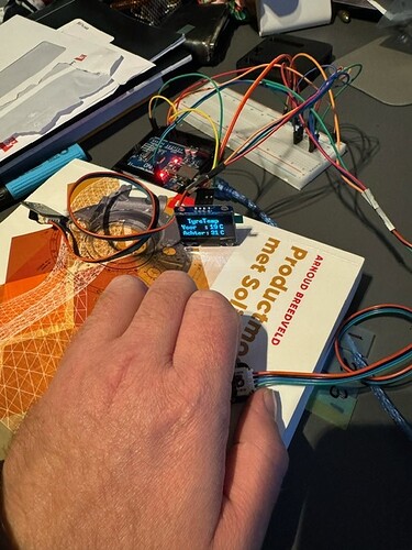

Hee Guys,
i think i need help, small introductions name is Nigel 30 years old and I am from Holland. I am mechanical engineer so please be kind haha I am not a software pro or anything but I do like Arduino’s.
Goal
current project is for racing motorbikes, the goal (for now) is to display two int value’s (infrared temperature) for my front and rear tyre on a 1.3 inch Oled screen.
Current hardware
  • Two DFRobot MLX90614 infrared sensors
  • Arduino uno (for now later nano for on the race bike)
  • 1,3 inch Oled Cheap copy of heltec and with an SH1106 something chip I think
Wiring diagram
  • Just the o led and two sensor 5V supply en GND
  • Everything runs true the SCL and SDA port
Problems
  • Temp sensors are not giving a separate value but copy the value
  • If I do not adjust the clock speed sensor value s will be all over the place
Code see also below
  • I use the u8g2 lib because SH1106 chip and it is very well documented
  • Everything works well when I used just the sensors and the LCD with I2C
  •   i tried translating it behind the // in english i hope that makes it more clear
thanks in advance

In the first line you define MLX90614_I2C_ADDR to be 0x5A.
In the second line you redefine MLX90614_I2C_ADDR to be 0x5B.
In the third and forth lines, you define two instances of the sensor class, both of which use the address 0x5B, ie, the same physical sensor.
You need to do something like the following:
#define FRONT_SENSOR_ADDR 0x5A                                // mlx9614 Adres Front tyre
#define REAR_SENSOR_ADDR 0x5B                                // mlx9614 Adres Rear tyre
 DFRobot_MLX90614_I2C sensorvoor(FRONT_SENSOR_ADDR, &Wire);   // instantiate an object to drive the sensor (no clue bud it works)
 DFRobot_MLX90614_I2C sensorachter(REAR_SENSOR_ADDR, &Wire); // instantiate an object to drive the sensor (no clue bud it works)
which declares sensorvoor with the address 0x5A, and sensorachter with the address 0x5B.
Because it appears that by default the U8G2 library sets the I2C clock to 400KHz and leaves it there, and the MLX90614 has a maximum I2C clock of 100KHz. So yes, you've got to set the I2C clock to 100KHz yourself for the sensors to work properly.
@van_der_decken Thanks man for the response! Tomorrow after work i will try the sollution right away😃
Alright just out of curiosity: where did you found the clock speed numbers so quickly? I was trying to find them bud did not succeed.
For the MLX90614 sensor, I just looked it up in its datasheet. For the library, I read through the library source and noticed that the 400KHz value was by far the most common default frequency across the supported displays.
Thanks man for your help really appreciate it ! It works out great this way!
