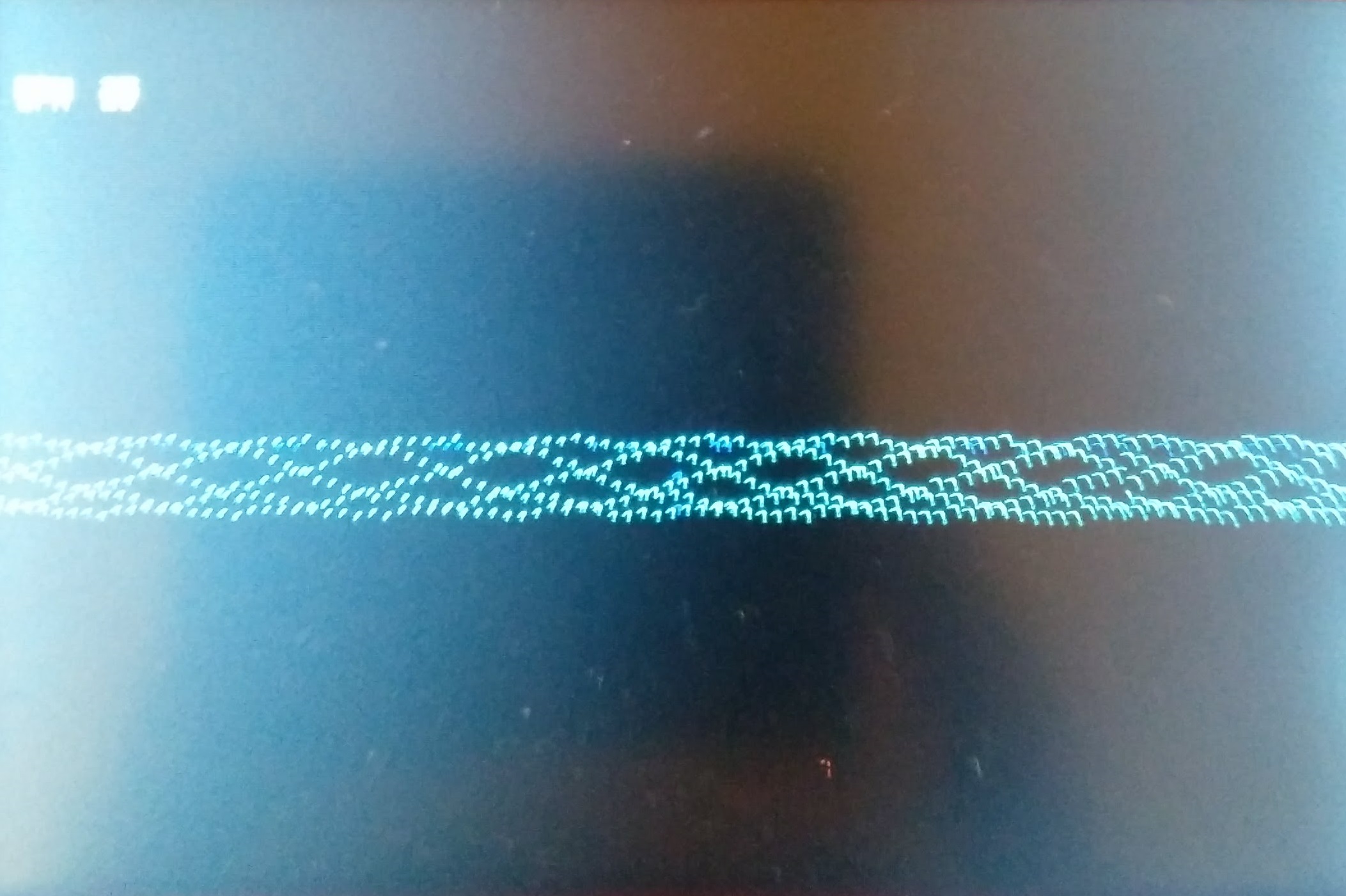

Hi guys. I've been trying to use a pulse sensor (Pulse Sensor Amped : ID 1093 : $25.00 : Adafruit Industries, Unique & fun DIY electronics and kits) to plot heartbeat and measure beats per minute. In order to calculate beats per minute, I've been using code from the following project: Heart beat Sensor and "ECG" Display - XTronical
Problem:
The problem I've been having is that printing the BPM piece of code makes my single plot turn into five plots.
Goal:
Accurate BPM measurements with single plot of heartbeat.
Attempt:
Here's my code.

  // Display BPM
  myGLCD.setColor(255,255,255);
  myGLCD.printNumI(BPM, 40, 34); <---- This line is the problem, I think.

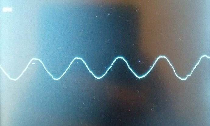

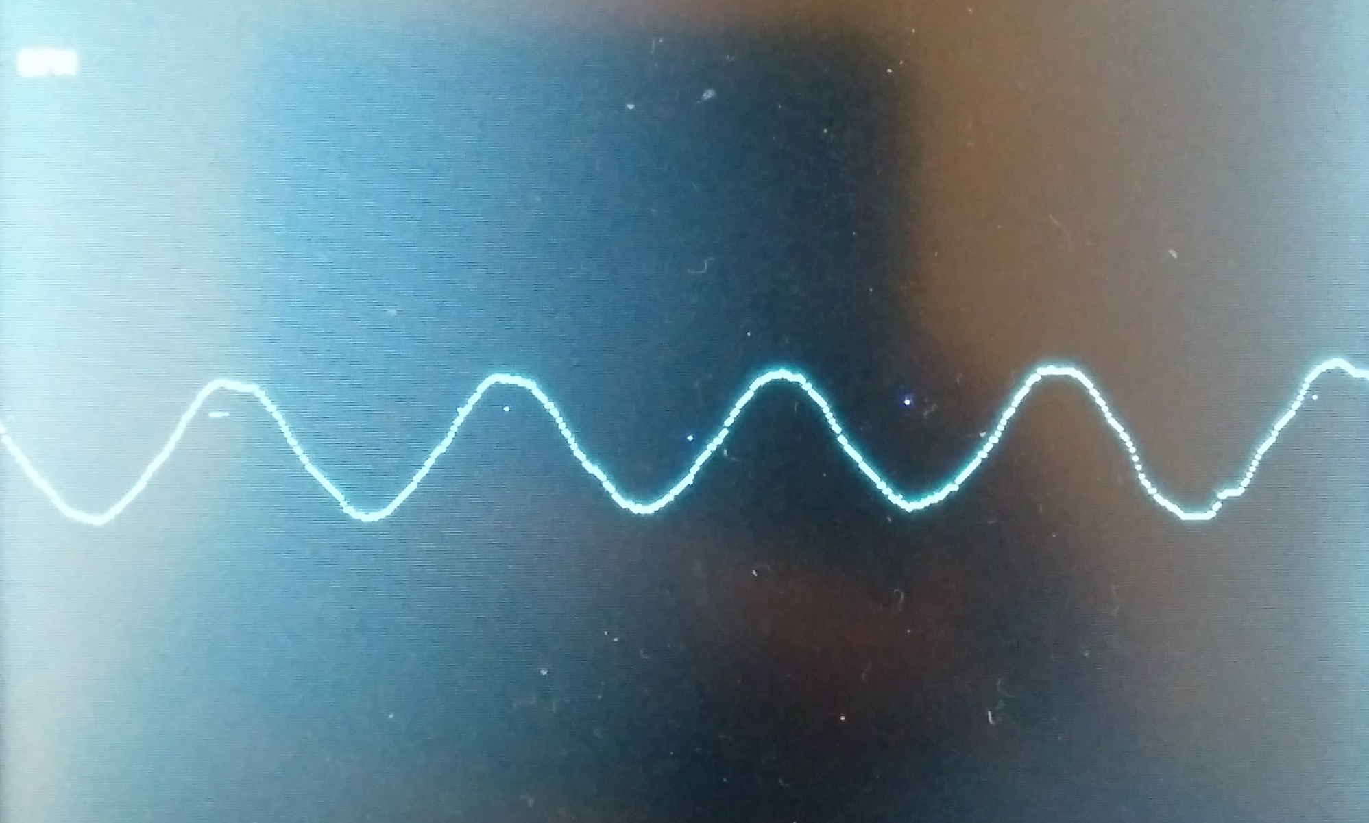

When "myGLCD.printNumI(BPM, 40, 34);" is commented out, the wave looks fine, as shown in the attached image. When it is not commented out, the wave looks like the second image, with multiple waves overlapping.
I've tried moving it to different positions in the loop to see if that changes anything. I can't figure out why it's having that effect when all it is doing is displaying a calculated integer.
Could anyone give me a hint as to why it may be doing this, or suggest a different way of displaying the required value? I've been through the UTFT manual and the only command that allows me to print an integer is "myGLCD.printNumI". Perhaps someone knows another way around this, or why the interaction is happening. Thank you.

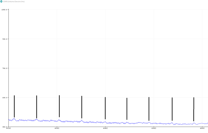

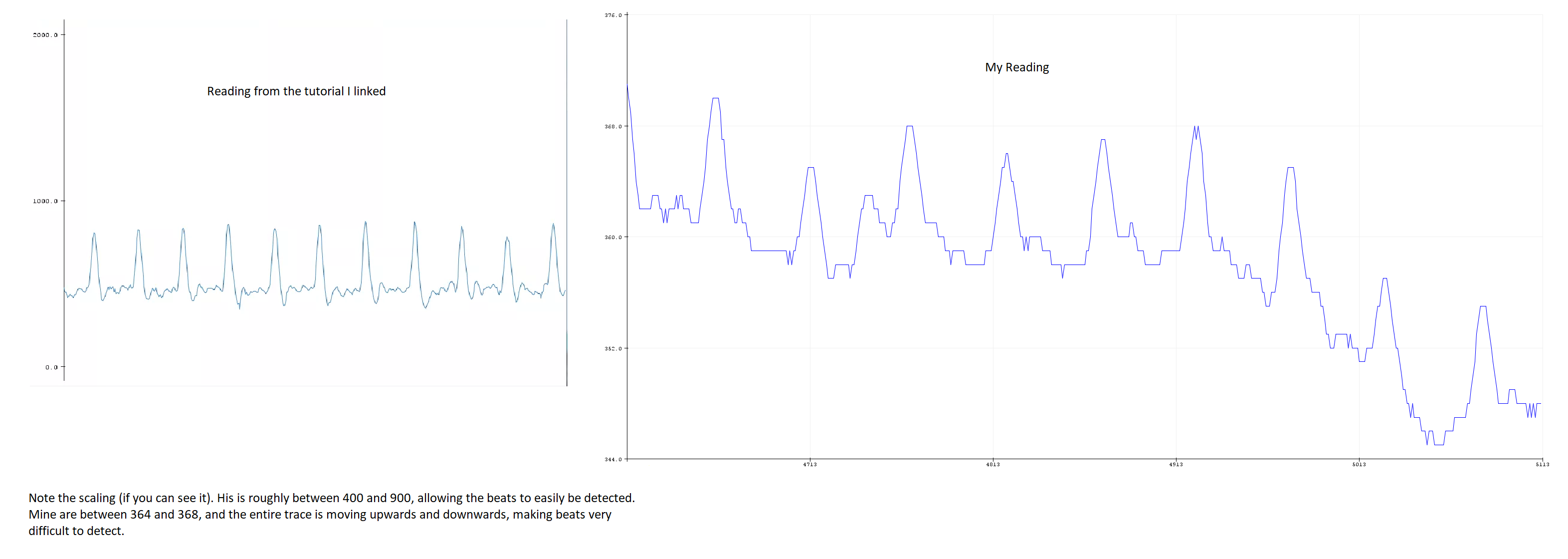

I can confirm after uploading the below code, that the beat is being detected correctly. It's not yet being drawn correctly, as there are two lines of pixels drawing the beat, and the beat is very small, but this is certainly progress. BPM is not being displayed correctly, but I suspect that's just because the boundaries haven't been set correctly by me yet. When the magnitude of the beat is nailed down, I expect I can start working on the boundaries to detect a beat then.

So the next issues I'll be addressing are the multiple lines drawing the wave instead of one line, the magnitude, and then calculating the BPM. I'll spend a few hours on those myself now that the beats are being read correctly, but if I do run into problems I can't overcome from intensive Googling or experimentation, I'll post in here again. Hints are always welcome! Thanks very much for your help thus far.

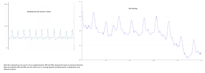

My pulse waveform certainly looks nothing like the one in this tutorial.
I have attached an image comparing the reading in the tutorial to my reading. The sensor being used is the same.

The first attached image shows the readings from the sensor using your code in place of a delay:
    static unsigned long lastTime = 0;
    const unsigned long INTERVAL = 20; //milliseconds, calculated as 1 divided by sample frequency
    while(millis()-lastTime<INTERVAL)
      //wait; do nothing until the sample interval expires
    lastTime = millis();
The second image shows the reading in the serial plotter if I use the following code, with a delay:
  Serial.println(analogRead(5));
  delay (20);
The difference between the two (aside from the amplitude) is that the first (your code) detects beats which correlate perfectly with what I feel. The second may display whatever is being detected perfectly, but the readings you see don't actually correlate with my heartbeat well at all. This is to be expected with the delay.
Do you know of any way to achieve the fidelity of the second image but using a similar method to your code? I've been trying to add modifications myself but without success. I will continue to experiment in the mean time, but I figured I'd ask here too.
Building on my previous post, I've discovered that I can remove your code and the delay. Neither are necessary if I change "if (BeatComplete)" to "if (BeatComplete == true)" in
int value = analogRead(A5);
   if (value > UpperThreshold)
        BPM = millis() - LastTime;
        BPM = int(60 / (float(BPM) / 1000));
        BPMTiming = false;
        BeatComplete = false;
      if (BPMTiming == false)
        LastTime = millis();
        BPMTiming = true;
    if ((value < LowerThreshold) & (BPMTiming))
      BeatComplete = true;
    myGLCD.setColor(255, 255, 255);
    Serial.println(value);
What this tells me is that the amplitude issue is somehow caused by the above block of code. Now to figure out why it's causing the readings to go behave as they do in the images I attached to my previous post.
I'll also add that the PulsePlayground library doesn't read the sensor correctly either. I'd imagine it should.
StringBean1:
Those two statements are literally identical. Something else must have changed in between the two tests.
