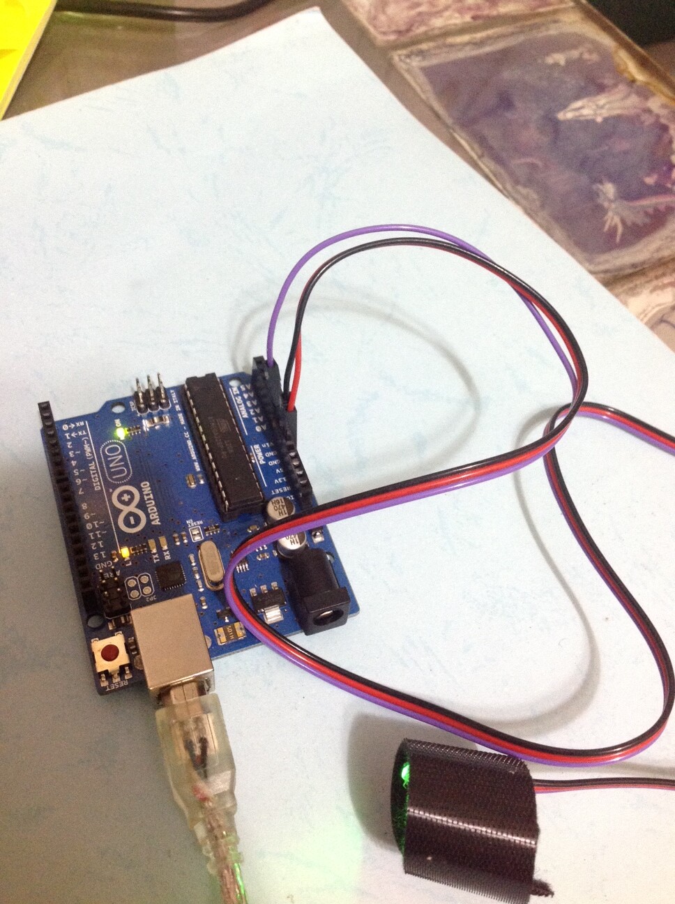

I try the exact code. But LED 13 doesn't blink when i touch it. The processing that shows the heartbeats work, but it only changes every time i touch it, where actually it is said that when we touch it it will continuously detect our heart rate without having to keep removing our fingers.
So I am planing on creating a simple code without using any processing code. And just print the hear rate in the serial monitor. But no luck it doesn't work.![]()
If the standard software does not work what makes you think your own software will work any better. Basically you have a hardware problem.
No the heart beat does not work if that is what it does.
These sorts of sensors are not as easy to use as you might think. You have to be very still and let the sensor settle down before it produces worthwhile results.

Let me just show the connection and screenshots here.
- I open the "PulseSensorAmped_Arduino_1dot1" in Arduino 1.0.1 ( there is 2 files open "PulseSensorAmped_Arduino_1dot1.ino" and "Interrupt.ino")

- I open the PulseSensorAmpd_Processing_1dot1.pde in processing 1.5.1, it opens 4 files (PulseSensorAmpd_Processing_1dot1.pde, keyboard_mouse.pde, scaleBar.pde and serialEvent.pde)
I upload the arduino code to the pulse sensor board. The pin 13 LED blinks. Then i put my finger on the pulse sensor. The pin 13 LED keep lights up (not blinking), which actually should blink every time it detects the heartbeat.
I include attachment for the connection and result both in processing and serial monitor.
Is there any way I can check whether it is working from the serial monitor?
Yes open the serial monitor and see what is printed there.

I have also problem with pulse sensor...got output 2 times of heart beat i.e 118.. so please help me..what should i change in program of arduino.
Serial.begin(115200); // we agree to talk fast!
I see a baud rate of 9600 in the serial monitor of "results.png".
