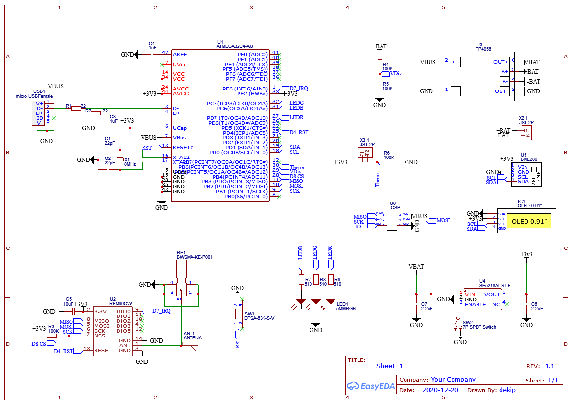

I made a project using 32u4 and RFM69 to send data from my heating furnace to my living room (temp, etc). As RFM69 works at 3.3V, I made everything on that voltage level, 32u4 too. This part works like a charm. I can upload sketches and it works. So, 32u4 has its 8MHz crystal and works at 3.3V.
RFM69, however, works... sort of.
Connecting the RFM69 module with 32u4 is based on Adafruit Feather 32u4 Radio with RFM69HCW Module (Overview | Adafruit Feather 32u4 Radio with RFM69HCW Module | Adafruit Learning System)
I use Radiohead lib, examples->radiohead->feather->radiohead_rowdemo_rfm69rx/tx.

When I upload RX on the other one, I can see it communicate with the module, but there is no data.
Both devices are the same.
Now, I know there are power issues. I set transmit power on 15. There is power from the PC on USB and the 18650 battery on both of them. The range between them is a few meters.

However, one must read the damn documentation. I forgot to mention, I use RFM69CW. In examples, by default, everything is set for RFM69HCW. Wich is not the same.
I commented out the setTxPower() on both sketches and everything works like charm.
