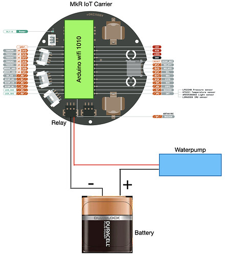

I'm working with an Arduino MkR wifi 1010 and MkR IoT Carrier. In particular I'm preparing a smart garden project and so, I connected a waterpump to one of the two relay of the carrier in NO mode. In addition I'm using also a moisture sensor.
I tried to leave the arduino+carrier for days connected to the power in order to monitor some quantities (light, temperature, moisture, humitidy, etc..) and I left the waterpump OFF for all the time. However, I noticed that after some times (maybe after one day), for some inexplicable reason, the object (arduino+carrier) reset itself and so, also all the relays (making the classic sounds CLIC-CLAC), as if it had lost the supply. In principle it is not a big problem, however it becomes a problem with the waterpump, because resetting itself (turning itself ON and OFF for some seconds), it gives water. And it's a problem if I connected all the system to a plant. It did it a couple of times. Has someone known something about this? Is it normal?

I would like You to post the schematics and links to data sheet of the various things You have connected to the controller. I'm not familiar with the names You tell in the post.
Whenever relays are involved the question about kick back diodes comes up. Relaymodules usually have that.
Any weakness in powering is one possible question...
Thanks a lot for your answer. Yes, I attach here the schematics of the circuit that I implemented (it's very simple), the datasheet of MkR IoT carrier and the schematics of the carrier. Moreover I upload also the datasheet of the Arduino wifi 1010

That waterpump needs a kick back diode. Is that Duracell a 9 volt PP3 battery? If so, use something giving more current. 6 x 1.5 volt AA could work.
Sorry my inexperience, what do you mean with "kick back diode"?
The Duracell that I'm using is a battery of 4.5V. I'm using this because when I bought the waterpump on amazon I read that the DC Voltage required was 5V.
If the problem was the Duracell battery why the MkR Carrier resets? Because I think that the problem is that for some reason (that I don't understand) the Arduino turns off and on in some seconds and thus also the carrier, but during the resetting process the carrier turns on and then turns off again the relays.

I don't "mean" anything. It's a technical term. Another name is "free wheel diode".
All inductive loads create bad sparcs, or over voltage, when they are turned off. Those diodes suppresses that. Those sparcs easily tricks electronics to go wrong, like a reset, or even get damaged.
5 volt pump powered by that 4.5 volt battery is ok. But, do some Google on those diodes and connect one.
