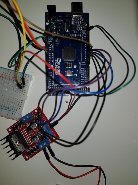

Hey guys,
i am new in this topic and I would need help.
I created a sketch to controll my DC motor with a joystick. Everything works fine with the on board 5.5 voltage. But if I'm using an other energy source, the motor is really slow but the extern enery is about 9 Voltage... also with a battery about 16.1 voltage it does not even move. Can anybody explain that? I am using a L298N Dual H-bridge.

Can you post a picture of your project so we can see your component layout?

Here is what i made.
I wanted to control the DC motor via joystick. So the amout of the POWER of the ENA has to be around 0 >= 255. Then the other thing is. You can use an extern power, but u have to remove the little jumper on H bridge. The led on the bridge is on, but nothing happens.

Your wiring does not conform to the pin designations shown in the final image. You don't have +12V connected to the H-bridge.
dougp:
I know. The difference is just to remove the jumpfer for the 5v and connect the 12 V battery. I guess so.
Explain (in this photo) what the wires circled in 'red' are used for?
Have you got the motor connected to the correct motor terminals?
What are you using as your motor power supply?
Do you have a DMM?
Thanks. Tom.. :slight_smile:
Don't use low current signal wires for the motor supply into the H-bridge - use wire designed to carry high current.
wopps. that should be the GND :'D Sorry my mistake.

Ya I suppose so. Its working with the power supply by the arduino. Or what do u mean with terminal? :o
I am using the 9V battery(u know that 9v block?). I also tried with an older battery pack with abou 16.8 Voltage. If I just connect the wires with the battery and the DC motor its working fine.

Show us a picture with your 9V or 16V power supply connected.
