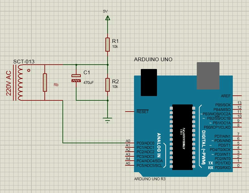

I want to measure current values using current transformer and library (EmonLib.h) in this example
#include "EmonLib.h"
EnergyMonitor emon1;
  emon1.current(A0, 30);
  double Irms = emon1.calcIrms(1480);
  Serial.println(Irms);
I use NodeMCU and SCT-013. I have succeeded. The values correspond to what the calibrated instrument shows but there is a problem. When the controller starts, it gives the first 3 values ​​not correct, but I need all the correct values.

scheme
What can be done in such a case?
Thank you.

You havent explained how the ct is connected to the Node - so a schematic please?
Is the current already established when you start making measurements?
I have attached the wiring diagram for the transformer.
https://www.researchgate.net/profile/Viorel-Miron-Alexe/publication/312038242/figure/fig1/AS:465224521261060@1487929577727/Schematic-describing-the-interfacing-of-the-SCT-013-current-transformer-with-the-Arduino.png
You can choose any of the available data transfer rates; it does not affect the values that are formed after a restart. The main problem is that the values jump when the controller is restarted...
The output from the current transformer is an AC signal, that is biased to 5V / 2 by R1, R2
Because C1 charges from a source reisitance of R1//R2 = 5k you have a time constant of about 2 sec.
there will be a period of about 5RC = 10 sec before the bias vboltage becomes stable.
So You MUST ignore the first 10 sec before you start taking readings.
