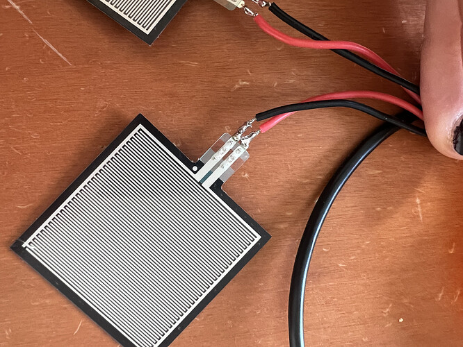

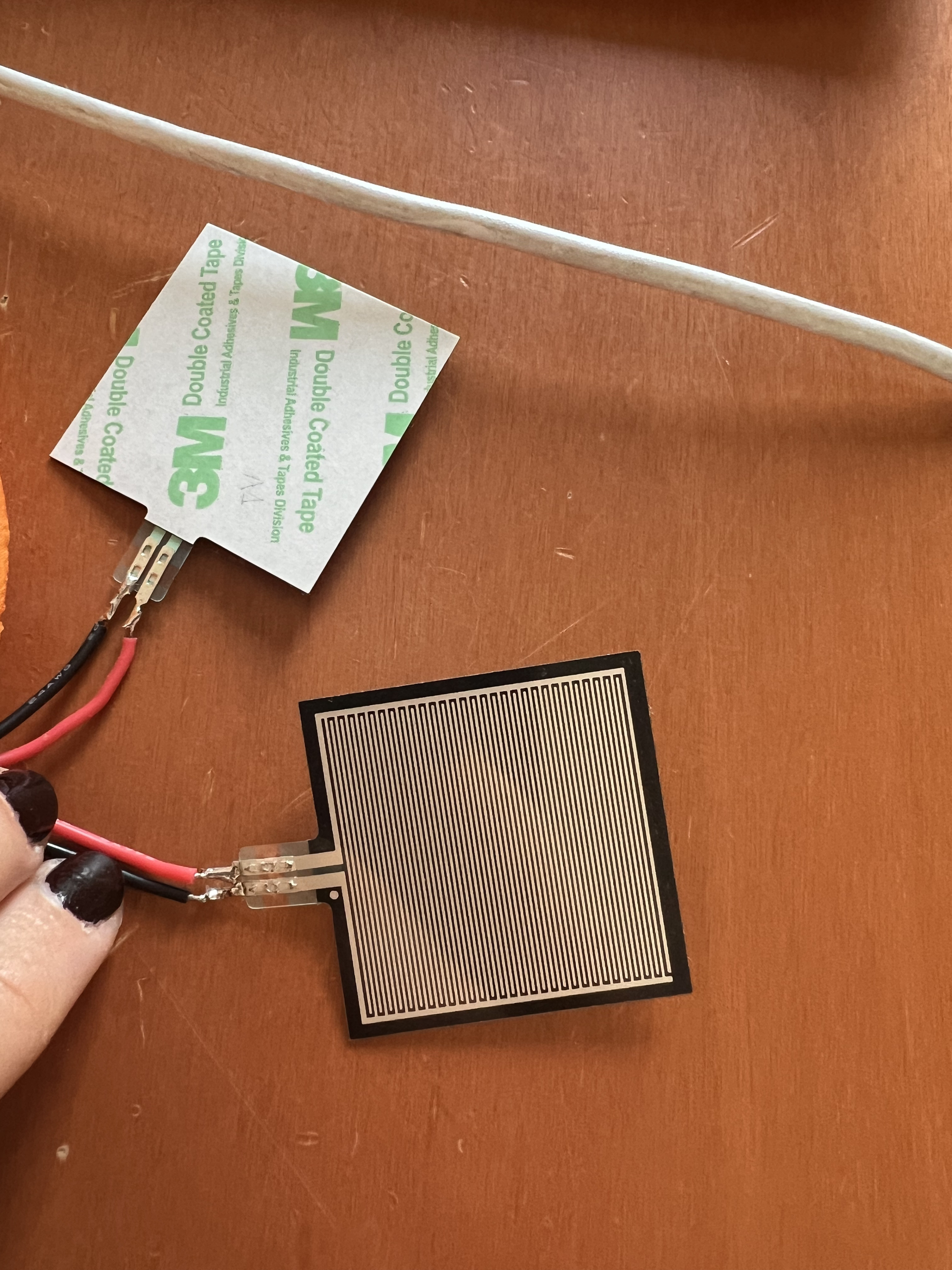

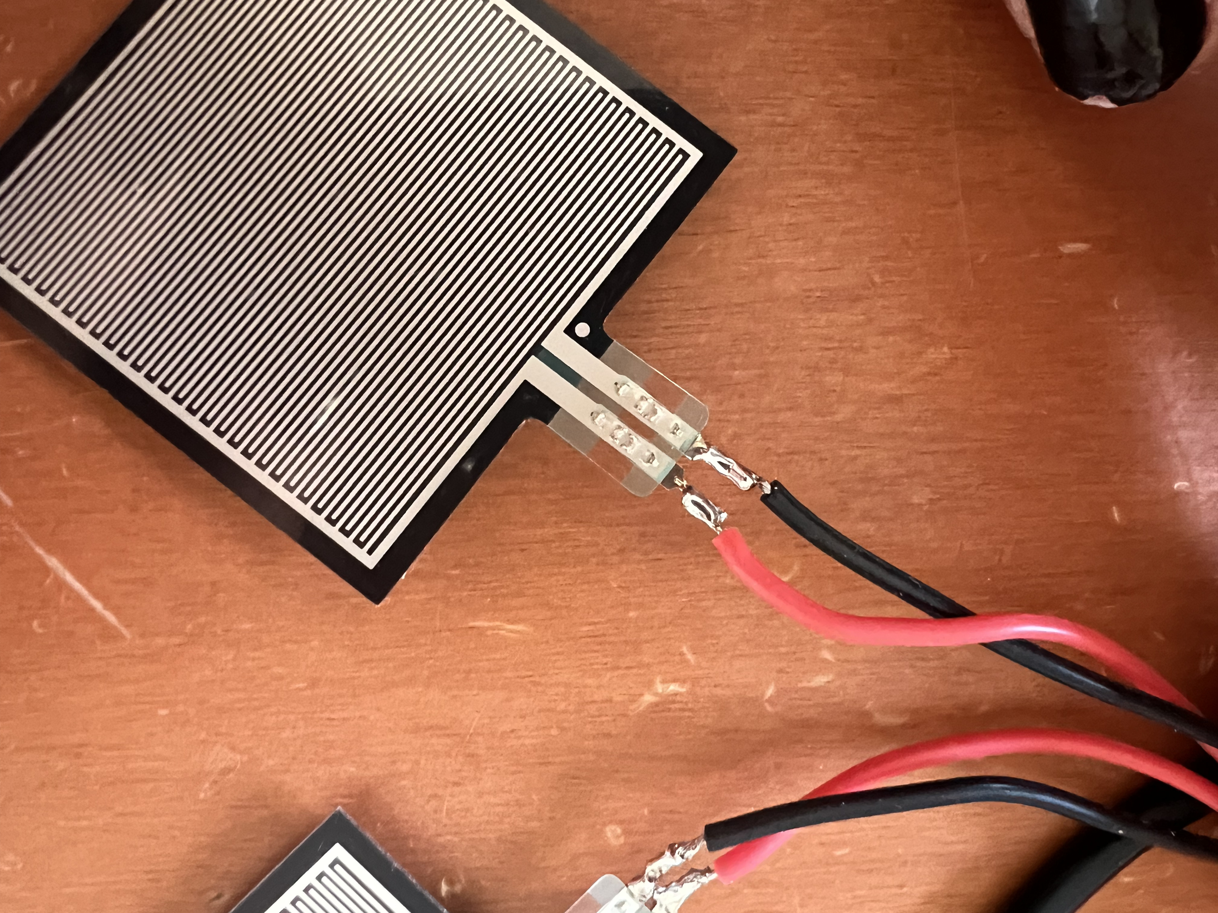

I have these squared force sensitive resistors, generally when I apply pressure to them with the fingers they detect pressure correctly, but sometimes I read datas like "900", "1000",ecc... in the serial monitor, when I'm not even touching them that much. It seems to give me this problem more often when I touch the black edges.

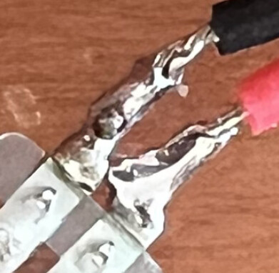

Could be a welding problem?
This looks very suspicious to me

I tried to separate with a sheet of paper those 2 welds and now it works, so maybe that was the problem

It looks and sounds like you need to brush up on your soldering technique
