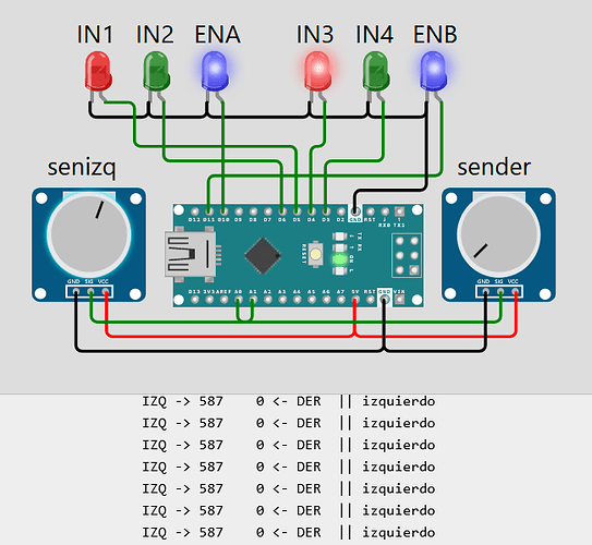

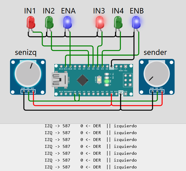

Hi, sorry if I have not chosen correctly the topic of my problem. The thing is that I am testing with my line follower, made with Arduino UNO. I made the code, also the wiring and the whole thing. Now, the problem is that when I go to turn it on, directly the wheels don't move even though the sensors and everything else seems to be in correct operation.
I attach my code, maybe someone can tell me why it happens as it happens (I already did a basic check to detect the problem, I checked if things were well connected and so on, but maybe I missed something).

Check your power supply.
Also... this...
if (sensorizquierdo...
will always be "15" and...
if (sensorderecho...
will always be "14" because...
//Sensor izquierdo
int sensorderecho = A0; // A0 is Digital Pin 14
int sensorizquierdo = A1; // A1 is Digital Pin 15
You should use the analogRead... in lectura()... if (senizq...
void lectura(){
   senizq= analogRead (sensorizquierdo);
Same with sensorderecho... use if (sender...
