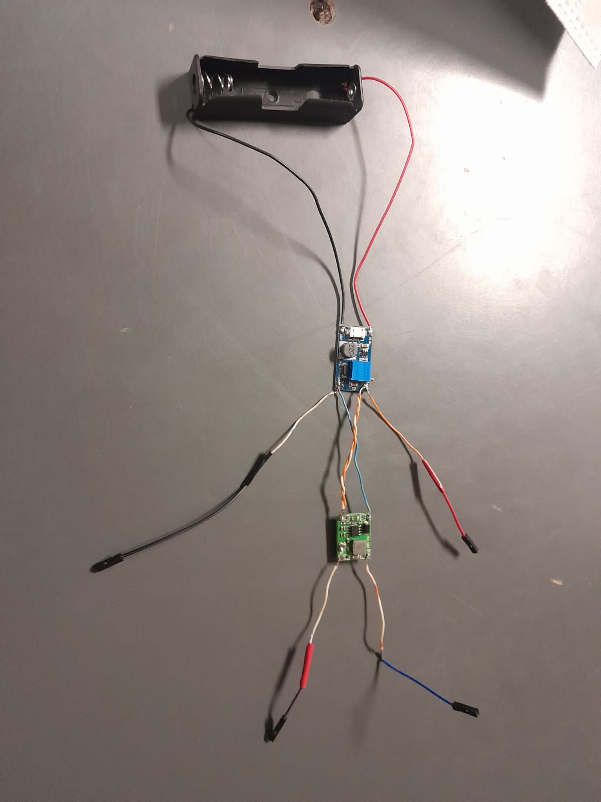

i got two 3.7v battery, one is 7800 mAh and the other 2800mAh. the circuit is basically the same on the transmitter side as the receiver:
3.7v battery > stepup (5v) > stepdown (around 3.24v in one of the stepdowns bc it has larger jumps and when i try to regulate it to 3.4 it jumps to 3.8v. the other is regulated in 3.4) > nrf24l01.
the stepups are intended to power the arduino and the esp32 but i'm not wiring it rn bc i'm powering it with usb as i load the code. i used protoboard wires, stripped them and soldered them to the stepup and stepdown pins, but i didn't solder over the arduino, nrf or esp32 pins. i tried using male and female jumper wires but i had the same result. this sounds complicated but i had to resort to an external power supply bc the 3.3v pin of the esp32 and arduino didn't give enough current to my nrfs.

here's multiple photos of my wiring
i'm sorry if the pics look blurred, my phone doesn't have a good camera.
i'm sorry, here's a diagram and photos of my wiring. the diagram is what i want to do, but the esp32 and the arduino are not connected to the battery for the moment as i power it with an usb for the moment.

i'm using female wires. i finished soldering, here's what my circuit looks like now. sorry if it's a bit more confusing but utp wires don't have black and red wires inside...
it's esencially the same as before. the connections with the nrf are also the same but i didn't take a pic since it looks messy. i have put insulating tape in the connections where i soldered the utp wires with the female heads of the dupont wires so it's more durable.

i also tested the voltage with a multimeter and everything seems ok. the nrfs don't seem to be fried as i get 3.2v on each.
