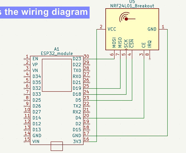

this is the wiring i used, it's not the same esp32 that i'm using but i looked for an espwroom32 pinout. i'm using the nrf24l01 + PA LNA
i'm not even sure what the problem might be, i was thinking on putting a capacitor between the gnd and vcc of the nrf but i've seen people that don't need it.

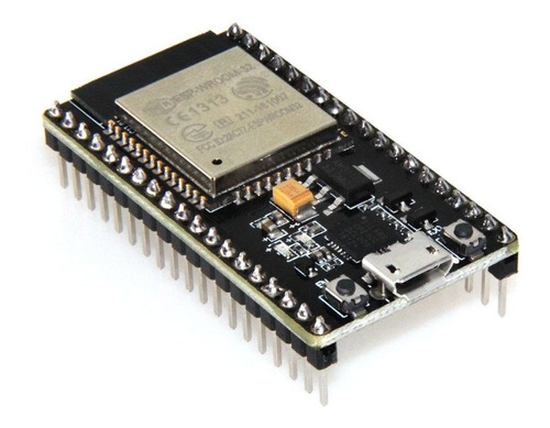

can you give a link to the specific ESP32 module you are using
Yes, that's not a problem in principle. I have a similar setup running in a few places in my home, with e.g. an ATtiny microcontroller sending data to an ESP-based controller elsewhere in the house.

arduinos 3.3V regulator is not powerful enough for such demanding modules
is that code for the receiver NRF24l01? don't i need to check the transmitter first?
how can i supply it enough power current? i'm power supplying my esp32 with an usb right now for testing but i'm planning on putting a 3.7 battery and a step-up for power supply, and just plugging the nrf24 with the 3.3v pin of the esp32. is there a way to support the power consumption without another battery?

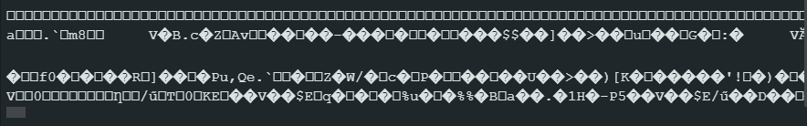

i tried other code. i'm getting weird symbols on the serial monitor. this is my code and this is my wiring

bauds are matching with the code
how can i know the problem then? i tried setting the PA level to low since i have my modules close together, i tried switching the ports, and i always get "failed to send data". is there a way i should run the codes? first the transmitter and then the receiver or the other way. i've read that the reset button of the esp32 doesn't reset the nrfs, so i constantly disconnect the power supply too to reset them. i'm not getting why it's not working since my code is fairly simple
This is almost certainly due to either a connection problem between the processor board and the radio module or improper powering of the radio module (as has already been mentioned is a problem with your setup).

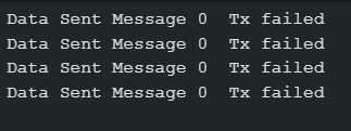

i tried using a nano as transmitter and an esp32 as receiver as i intended at first but still no luck, the transmitter's serial monitor displays a bunch of "Data Sent Message 0 Tx failed". i've soldered a capacitor across gnd and vcc as i've seen a lot of people recommend. it's not in my plans to use an external power supply other than my esp or my nano or buying the adapter and i've seen a few people having problems with those too. i have a 3.7 battery and a stepdown that i can use for testing though. i'm plugging the wires directly.
i tried using my 3.7 battery and my stepdown to power supply both nrfs and i'm finally getting something different, though i still have a few problems.
on the transmitter serial monitor (arduino nano):
SimpleTx Starting
Data Sent Message 0  Acknowledge received
Data Sent Message 1  Acknowledge received
Data Sent Message 2  Acknowledge received
Data Sent Message 3  Tx failed
and it goes on with message 3 tx failed
